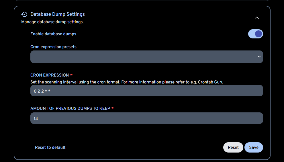

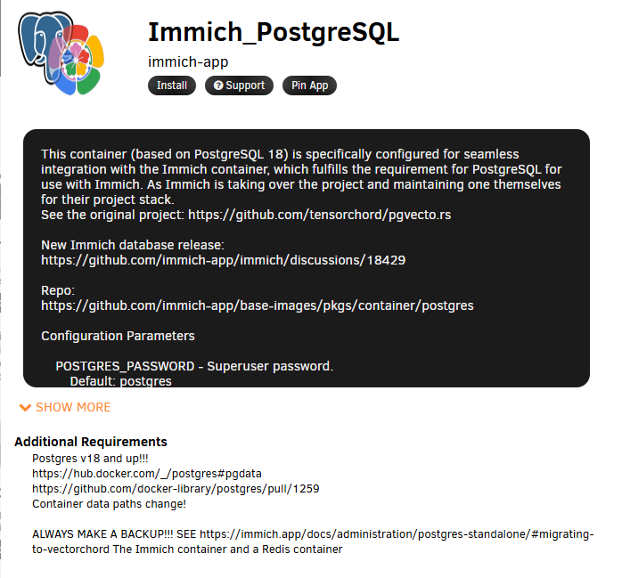

imimch it slef droped support for pg xxx plugin and imich decided to maintin ther own postgress docker image using the new supported plugin vectorchord.
this was during postgressv14 being the norm. v16 being the go to staple and v18 being the bleeding edge.
Image genious(the mainteiner of teh docker image for the unraid CA) after working with them pushed to update and migration that now requires vetochord over the pg plugin. Immich mainting ther own docker image gave usrs the abilty to move and update by usin ghte tag with both pg and vetochord...
YOU HAVE ALWAYS BEEN IN CHARGE OF YOUR OWN DATA AND BACKUP!
Immich them selves want you to use the docker compose method. Space invader atempted to help as trtying to have novice and others use edit and have compse on uraid was still a beta things and not easily expalined nor gone over...
He partnered with image genios who shipes a docker image that runs both the imich server and imch remote learning in 1 docker.
So the question has and will always be. Do IO run CA and folow image genious update stack, github and notes. Or Do i follow the immich stack mainter github update and notes.
Thsi caused alot of issues and drops form the platform as they worked themselves out...
Meanidn that a UpDate path REQUIRES a good working postgres tag and the backup and restore (migrations) of the postgress version.
Image genoius recomedns runnign postgress v16
imache compose recomend runing v18
folwoing EOL and realse cyclesw postgress v16 is not EOL untill 2028
https://www.postgresql.org/support/versioning/
so there is no direct answer to "CORRECT" update path...
it was for that reason that I made the new CA immich dockers to help easy the transtion. ANd web to a Webstie for guide due to issues with Unraid forum and suport pages...
review:
https://medium.com/@damngoodtech/how-to-easily-restore-a-postgresql-database-in-a-docker-container-23ccfaa3d60b
https://davejansen.com/how-to-dump-and-restore-a-postgresql-database-from-a-docker-container/
https://docs.immich.app/administration/backup-and-restore/
and if running unrad CA method you are running in a postgress standalone:
https://docs.immich.app/administration/postgres-standalone/
new install guid for CA:
https://bmartino1.weebly.com/immich-on-unraid-ca-docker.html
Only thing that changes is whe you launch postgress you run the postgress resotr comands...
New install copose:
https://bmartino1.weebly.com/immich-on-unraid-docker-compose-guide.html
THe mainteriners recomend method...(more due to univeral; across any and all linux distors...)
Ther are many way to interace with your postgress dsatabase to backup, dump rstore...
simlarly the immich defualt folder layout or storage tempalte and volume mapoing. Yes you can maintin your old data and transtion to the curent working known stable models... BUT YOU ARE ULTIMATE INCHAGE OF YOUR DATA!

Again with Compose its following the immich maintainers... atm they want v16... and v18 has some known problems...
IF you read the guides you would have seen:
Repository / Image ghcr.io/immich-app/postgres:16-vectorchord0.3.0-pgvectors0.3.0 (or current Immich GitHub Tag)
https://github.com/immich-app/base-images/pkgs/container/postgres/versions?filters%5Bversion_type%5D=tagged
as time of writing... curent tag info:
https://github.com/immich-app/base-images/pkgs/container/postgres/658270704?tag=18-vectorchord0.5.3-pgvector0.8.1
since we are using taged version and not "lattest" you have to watch an maintain docker updates yourself when and if using compose... (postgress doen't support using latest tag and requires databazse backups and resotres...
*all in the support post even going over the isseus with v18!!!
SO! If you want v18 Use the Unraid CA... other guide or ask on the immich github. or others on the supoprt post where your questions belong...

        image: ghcr.io/immich-app/postgres:18-vectorchord0.5.3-pgvector0.8.1
So all i can say to assit you is to go ask ai. But its your actions and the reason why I have this guides as separate websites as PEOPLE DON'T FOLLOW THE FORUM RULES AND IF I'M bound to them then so will you!
Please ask questings here https://forums.unraid.net/topic/146106-immich-docker-self-hosted-google-photos-setup. Otherwise the mods alrady know as i will remove the Guides out right as it has nothing to do with the guide!
To many have not asked nor stated a clear as mud question and some of the question is also so baisc/retrorical that you need to go do it your self and learn docker compose...
SO AGAIN!!! to use v18 you have to 1 change the tag:
image: ghcr.io/immich-app/postgres:16-vectorchord0.3.0-pgvectors0.3.0
and 2 add docekr varables to fix the changes...
to me its cleare you didnt' folow nor read any of the guide post! and I'm done...
SO REVIEW:
review:
New install copose:
