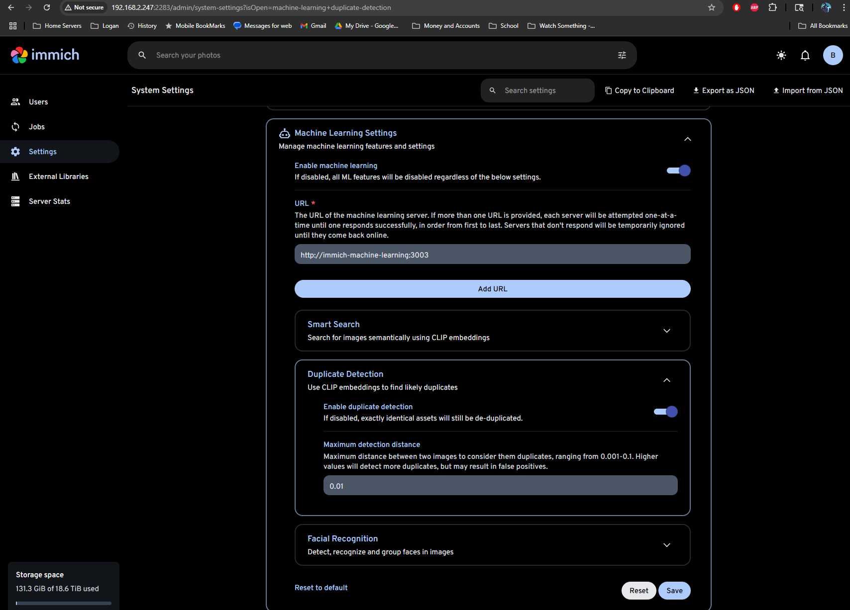

Hey, i have issue where a lot of images seem to be flagged as duplicate even if they are not, so they dont get uploaded. It is not a small amount, around 600, so i cant edit all of them a bit and the upload them so that hash is different.
Is there a way to turn off the duplicate detection?

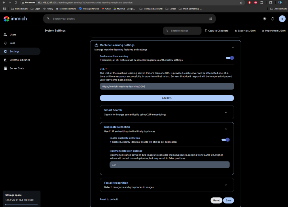

On 6/8/2025 at 9:28 PM, bmartino1 said:
kinda...
https://www.reddit.com/r/immich/comments/1c63ryv/immich_duplicate_finder/
To disable duplicate detection in Immich, you can adjust the Maximum detection distance setting in System Settings under Administration > Settings > Machine Learning Settings > Smart Search. A higher value will detect more duplicates, while a lower value will detect fewer. You can also disable machine learning entirely, which will also disable duplicate detection, under Administration > Settings > Machine Learning Settings.
Detailed Steps:
Access Administration Settings: Log in to your Immich server and navigate to Administration > Settings.
Locate Machine Learning Settings: Navigate to Machine Learning Settings, specifically under Smart Search.
Adjust Maximum Detection Distance: Find the "Maximum detection distance" setting. This controls how closely images need to match to be considered duplicates.
A lower value (e.g., 0.001) will be less sensitive and detect fewer duplicates, but may also reduce false positives.
A higher value (e.g., 0.1) will be more sensitive and detect more duplicates, but may also lead to false positives.
Disable Machine Learning (Optional): If you want to disable duplicate detection completely, you can disable all machine learning features or specific models like Smart Search. You can do this under Administration > Settings > Machine Learning Settings.
Disabling machine learning will also disable other features like smart search and facial recognition, impacting the Explore page and search functionality.
Save Changes: Make sure to save your changes after adjusting any settings.
Alternative: Disable the entire machine learning service (advanced):
To prevent the machine learning service from starting at all, you can comment out the immich-machine-learning section in the docker-compose.yml file.
This will disable Smart Search, Face Detection, and Duplicate Detection tasks.
If you do this, you'll need to manually retry any tasks that rely on these features by clicking the "Missing" button on the Job Status page.
Thanks, i did not see that option at all. This did fix the issue
