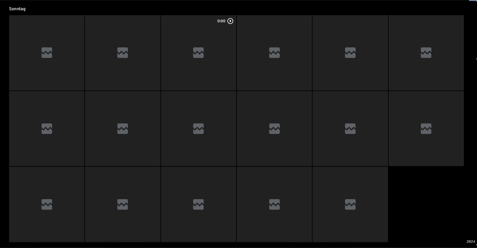

I'm not sure what's going on. After images/videos uploaded, thumbnails don't work. When i open immich web-ui, its extremely slow.

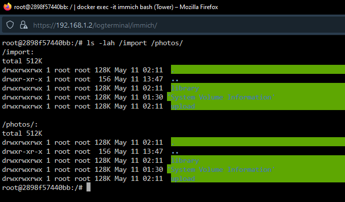

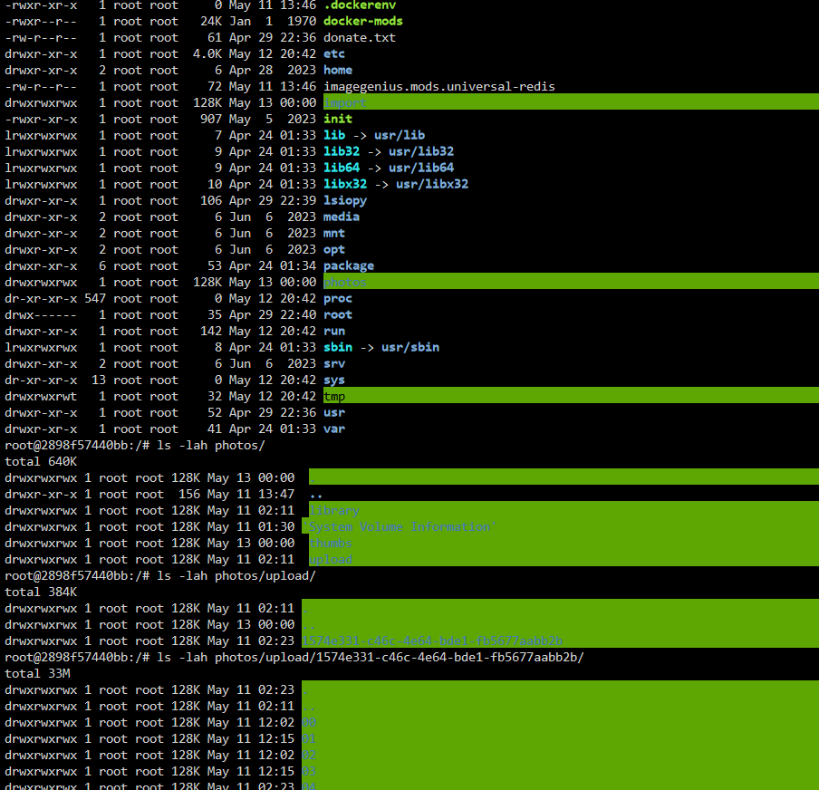

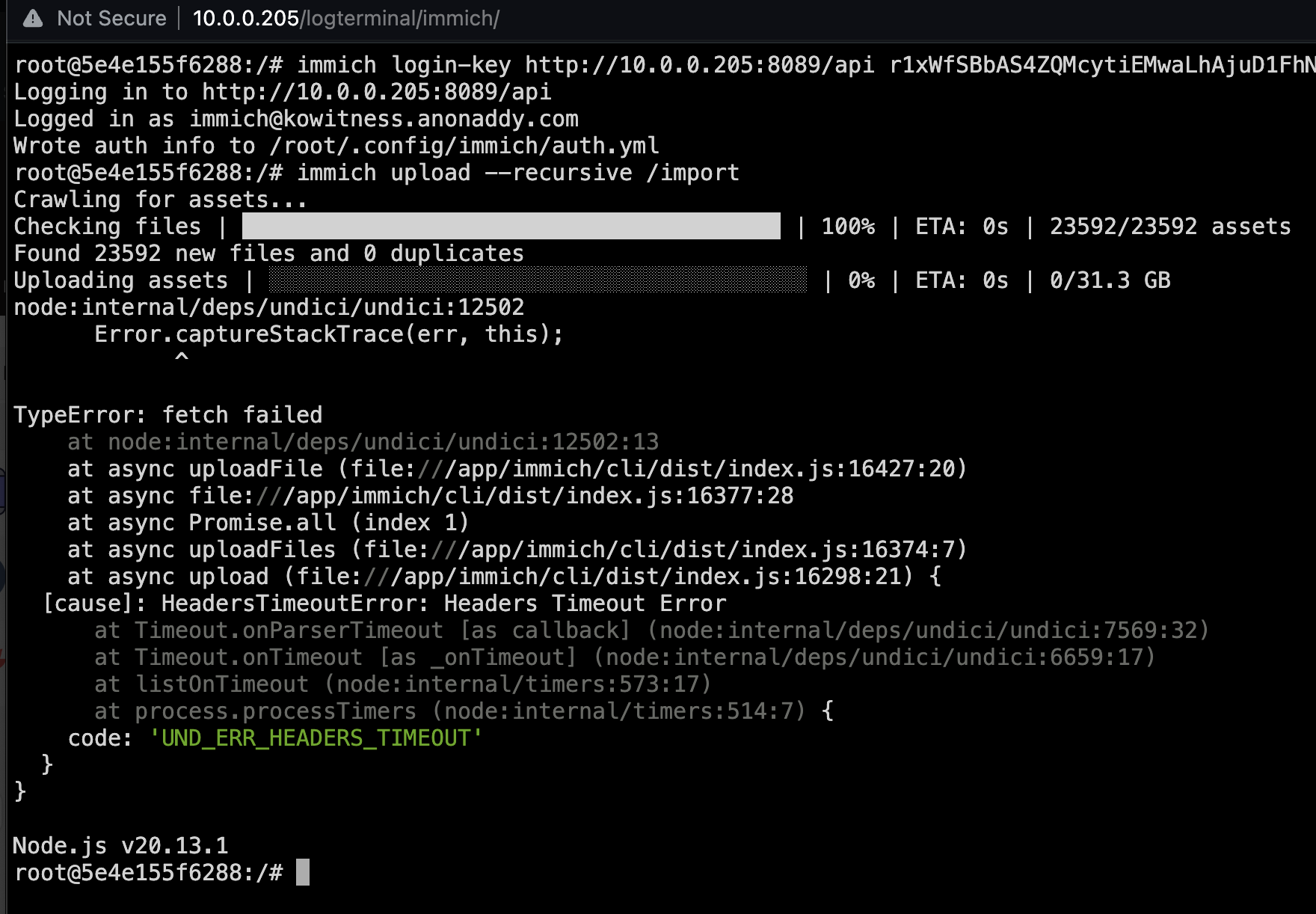

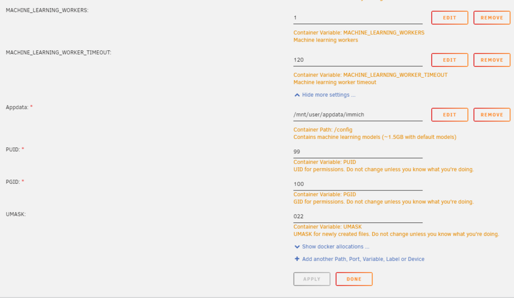

I've got a pretty big library, over 150K pictures and around 10k videos, 1.5TB in size overall. As you can see on the container configuration, i've got
/photos -> /mnt/cache/immich-previews  (internal library, I guess, but this is 195GB in size and is full of thumbnails)
/import -> /mnt/user/fotos (external library with my folder organization untouched, I do create forlders as albums there from my own sanity as I sync/uploads pictures and videos to manage them).
Is this somekind of permissions problem? A 'ls -la' shows as follows on these directories:
drwxr-xr-x 7206 javipas  users 7208 May  2 08:30 fotos/
drwxrwxrwx    6 nobody users    6 Feb 10 09:08 immich-previews/
Thanks!

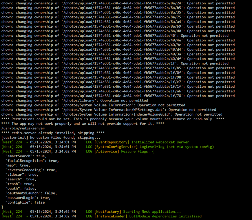

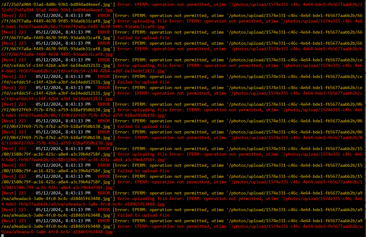

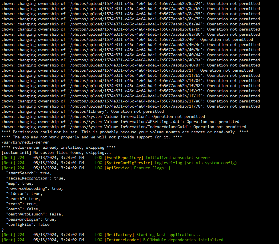

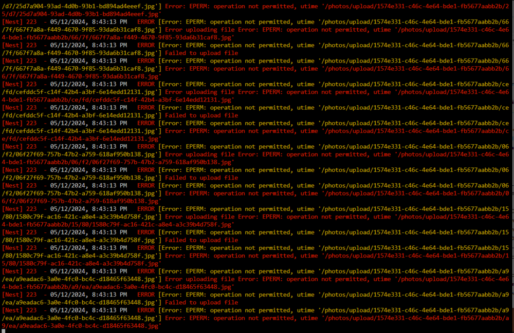

does someone has the same error?
( Immich logs )
( immich console )
@srepper looks like permissions problems. Have you googled around for Immich permission problems? Have you restarted the docker?
Edit:
Found the issue: I used my USB drive. I can create and do stuff with it but not my docker.
Thanks !

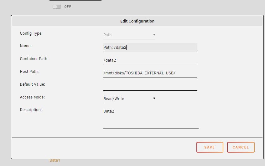

Thanks for response. I google arround immich permission problems, but didn't find any solutions.
I restart it oftern, but same issue..
maybe because my usb drive is my storage?
Edited by srepper

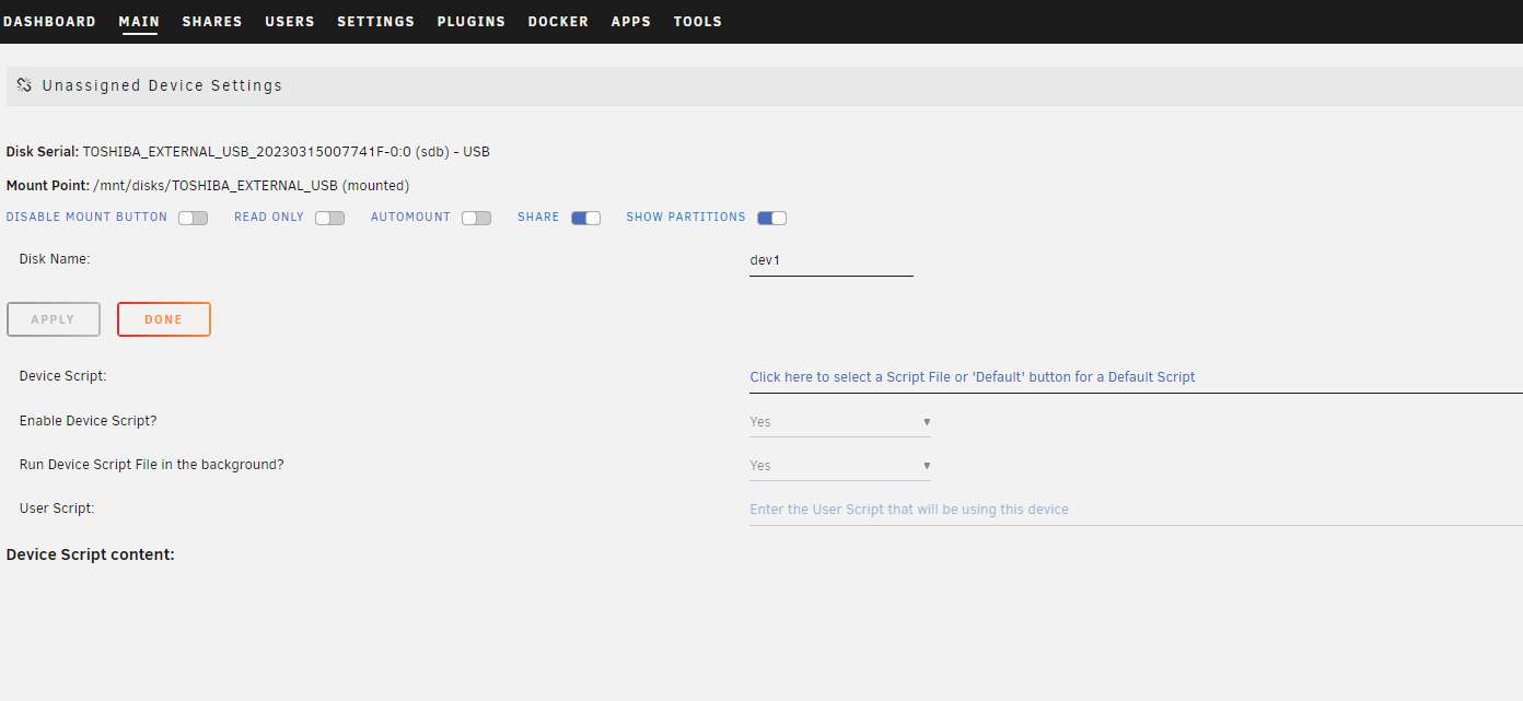

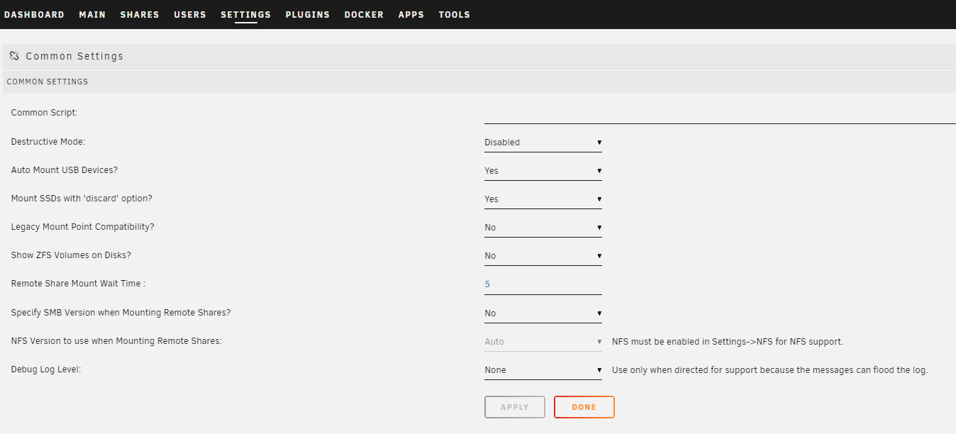

Here's a thread about docker permission issues:

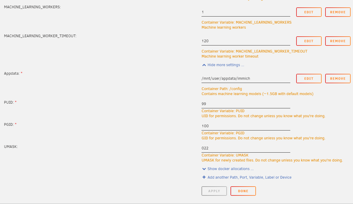

Under your Immich Settings, hit Advanced, make sure those permissions down there are correct, like these in mine below.
I also saw a crossed out thing about your storage being somewhere else instead of a normal data disk in unRaid?

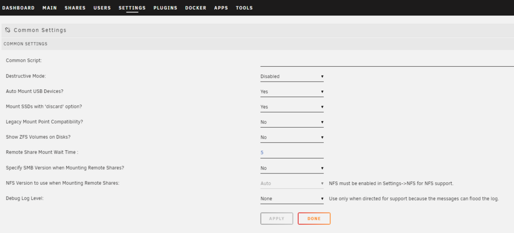

Also check Common Settings under Settings for Unassigned Devices
I seem to remember changing something in here a while back... Maybe that Destructive Mode thing? I don't exactly recall.
Also the Main > unassigned devices > Settings gear on the drive you're mounting
Hopefully this will get you somewhere!

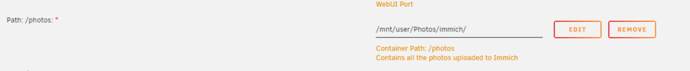

Looking over some other messages you have: looks like you probably linked the USB (?) folder via the Docker Settings for Immich. Make sure you got that right too. Let see if I have that somewhere...
I also have a Syncthing going, and it IS writing to an external USB drive. Here are the settings for adding that drive into the docker settings for Syncthing, your addition to Immich, to ahve access to that USB drive would be the same:

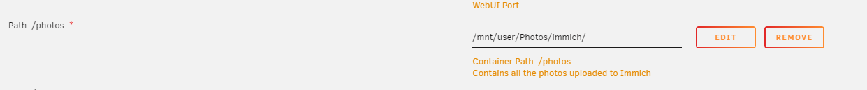

I suffered a disk error on an Unraid install which had Immich on it and now that container won't run. Fortunately I was able to copy all of the files off though, so now I'm trying to import them elsewhere. It looked like it was working until it got to the "uploading assets" step and failed - any idea what I'm missing? Here's a screenshot of the error:
I see that my storage is always full? Is there a way to correct this information on the dashboard?
As you can see here, I have 720GB available
@mbc0 so 2.7TB, does that seem right to you? Do you have anything that’s 2.7TB? I suspect your file paths are incorrect in the docker, then the Immich settings.
revisit the setup instructions, pay close attending to Docker Settings > paths
then also, once you get that Immich docker going, where those paths are pointing.
Thank you, I will recheck again, I was sure all was ok but will have another look!
