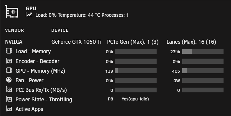

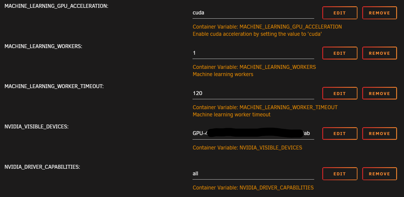

    @mbc0 So, it looks like you have made the GPU available to the container, but you also need to turn on GPU acceleration in the Immich settings. Also, imagegenius recently changed how the AIO

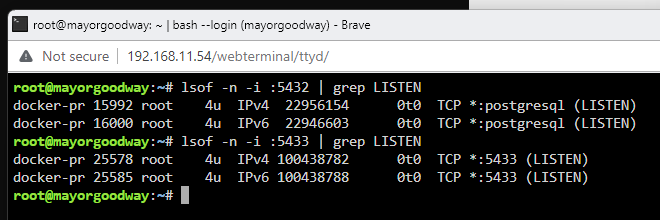

So the connection to your postgres docker isn't working. That's what you need to focus on. I added a screenshot of my Immich container settings, so you have both of those. Check those over carefully. And focus on the connection between Immich and PostgreSQL_Immich containers.
This command can be helpful for some action
root@mayorgoodway:~# lsof -n -i :5432 | grep LISTEN
You run that from the regular unraid command line, and it will tell you WHAT, if anything, is listening on that port. I did these two, I have postgresql listening on 5432, and nothing listening on 5433. I remembered this command (not specifically, but generally) when I searched for "troubleshoot postgresql connection docker" and this site popped

Looks like you have Redis connection problems. Check out the first post I modified a bit in this thread. There are settings for Redis, and those need all the correct port numbers. For me that's 6379, no password. Redis hostname is the statis IP of the unraid server. You do have Redis installed right?
I'll keep with this lsof thing! Here you can see that 6379 says <something> is listening on port 6379. It doesn't report that it's Redis. Then I check another port that's nothing, and it returns nothing: nothing on that other port. So that's a pulse!
Edited by rutherford
Thanks for your help!
I checked the port multiple times but never looked at the IP.... So my immich is running now!

So Redis is complaining about connection errors.
Did you see the post two above this one with the lsof command? Have you confirmed that redis is listening on that port? Then change the command to bump it up a couple ports so you see what a failure looks like, and make sure it's not that on the port you think Redis should be listening on.
A google search about testing Redis docker connections found this stuff https://stackoverflow.com/questions/41371402/connecting-to-redis-running-in-docker-container-from-host-machine
Not much applies, but you could try the last parts of the troubleshooting from there about redis-cli stuff, if you can find that binary somewhere, perhaps in the Redis console.

Has anyone gotten an intel iGPU working with immich?
Machine Learning using Nvidia GPU
I have it configured as such but not confident its working as expected. CPU runs at 100% and I am not seeing any activity in GPU monitor. Anyone else have ML working?
Cheers,
