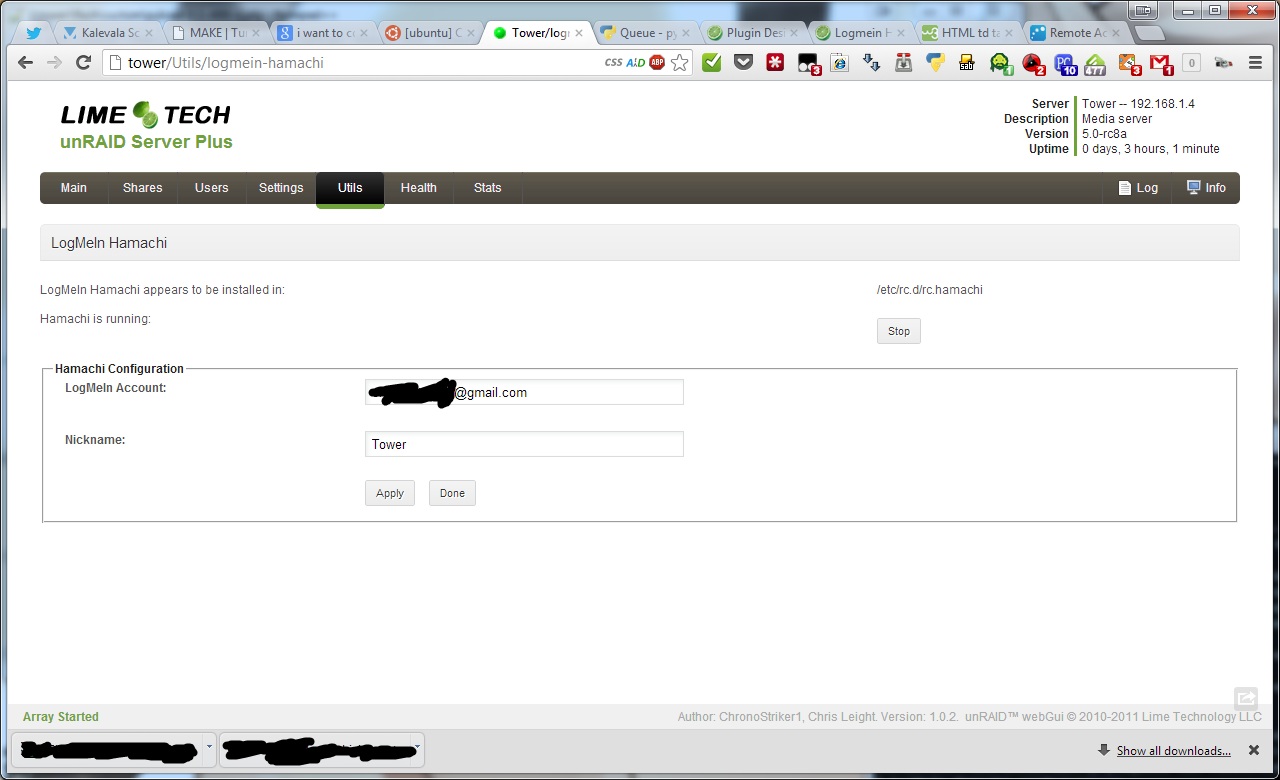

October 30, 201213 yr Made a small change to the plugin to show the account and nickname correctly, and fixed some text overlap. Also commented out a line that removed the plugin dir on the flash drive, I cant think of a good reason why it would do that. I would cause me to loose my config every reboot. Rename txt to plg logmein-hamachi-1.0.4-noarch.txt
November 14, 201213 yr Made some more changes, there is now a button to save your settings, it runs /etc/rc.d/rc.hamachi save This should cause hamachi when installed to actually restore your settings... Since I never read the inital post on the tgz I never knew about it... I am also trying to get it to apply a network an password from the config page, unfortunatly I only get it to say its failed, busy. So any help with that would be apreaciated logmein-hamachi-1.0.5-noarch.txt
