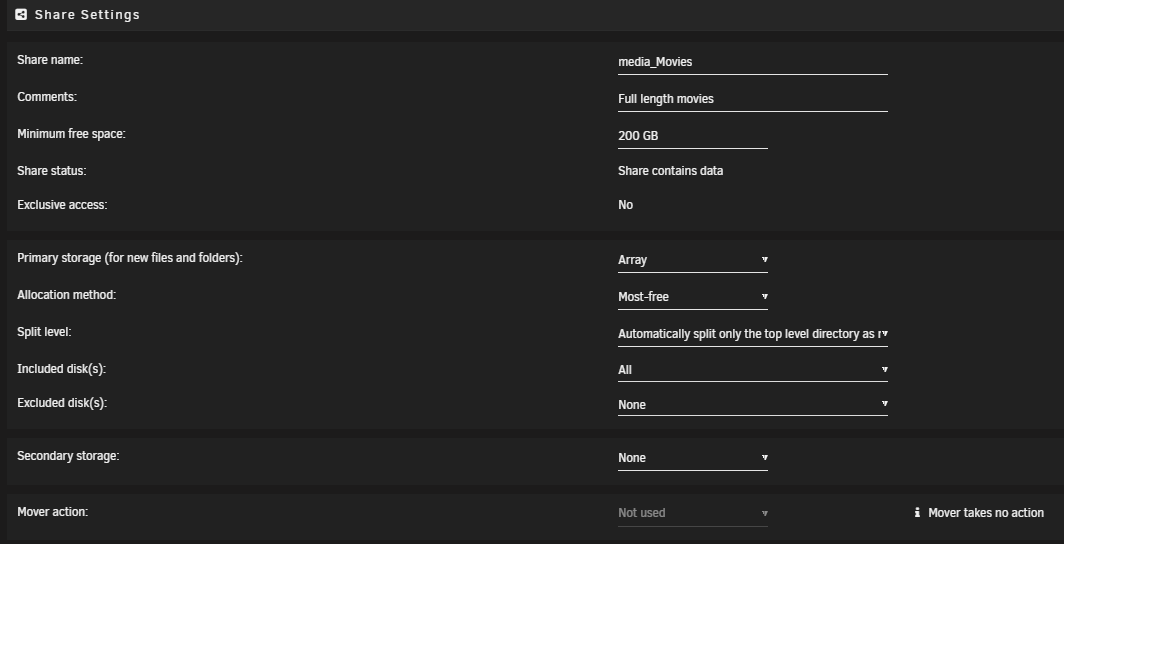

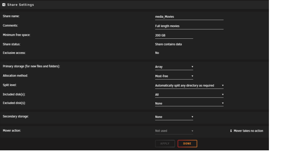

I'm in the process of moving media folders from one folder to a new one with a split-level set to "Automatically split the top level as required" (movie folder). All drives are included in the share, with no exclusions and I have a minimum free space set to 200Gb. I can see that new folder on every drive, and the File Browser confirms it, and that the split-level is correct. I originally set to "High Water", but it does the same when set to "Most Free".

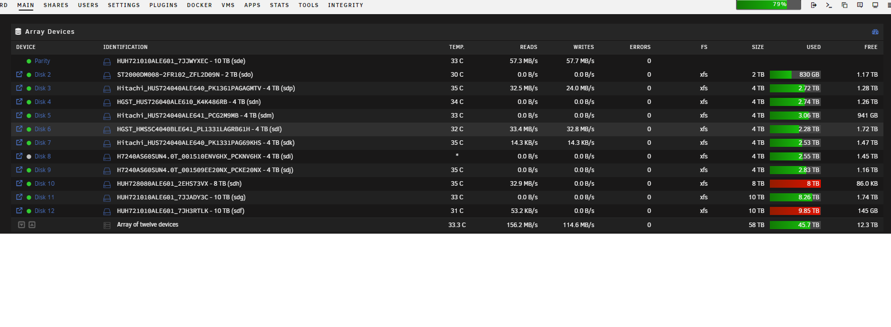

The problem is that it when using the File Browser to move the media folders, I started getting "not enough free space" errors. Sure enough, one drive was completely full, with 85kb (or something like that free), and a 2nd drive was down to 145Gb.
I'm currently using the Unbalanced plugin to force move folders from the 2 full drives onto the least full drives.

I cleared up some space on the 2 completely full drives with Unbalanced, leaving roughly 500Gb each. I'm going to try using the File Browser to Move the media folders that are split among multiple drives again.
Edit: I started the Mover manually to clear it, and started manually moving the split media folders again. I instantly saw the available free space dropping on the drive that is almost completely full (280Gb) while there are multiple drives with 1.25Tb+ of free space. The share is set to use Most Free space.

Split level overrides allocation method, try setting to split all.

In the event of there being conflicts between the Minimum free space, Split Level and the Allocation method settings in deciding which would be an appropriate drive to use, the Split level setting always wins. This means that you can get an out-of-space error even though there is plenty of space on other array drives that the share can logically use.
What that means is that the split-level feature is completely worthless, unless you have a single drive with unlimited space on it. It's set to the lowest level split, but it's insisting on putting EVERYTHING in that one share on that one drive, while there are 9 more drives, with more than enough space available AND the same share on every drive.

And that will work if correctly set up and if the folders don't already exist on destination, also depending on your folder structure, the same split level may not work for movies and TV seasons, what is the current folder structure?
Maybe you are misunderstanding Split Level?   What is the path for the files for a given movie?   If they are all in a folder named after the movie then you might need a split level of 2 to keep them all together.
  If you do have everything at the top level, then you want to be using the Highwater allocation method as that would keep files together except in the rare cases where a particular file reaches a trigger point so Unraid switches to the next disk for the next file.  The Most Free allocation method would almost certainly put related files on different drives a lot of the time.
For the Movies, that I'm doing now, I have it set to "Top Level": /mnt/user/media_Movies/<movie>, which splits it at <movie> as it's supposed to do.

What is driving me nuts is that I can't move anything now until Unbalance clears more space on that one single drive because that's the ONLY place that the File Browser Move is putting the files now.
Dynamix File Manager will let you work directly with the disks so you don't have to rely on user share settings.

And, even now, I'm trying to move a single movie folder from '/mnt/user/media/movies' to '/mnt/user/media_Movie/movie' and it's putting it on the drive that is down to 85Gb, while the minimum space on that share is set to 200Gb.
WHY?
There are 10 more drives on that array, with all but one having 1Tb+ of free space. Why is it ONLY going to that ONE drive?

The files regroup into a single drive in a Move from the File Browser, BUT, file browser is ONLY writing to ONE of the ELEVEN drives.
