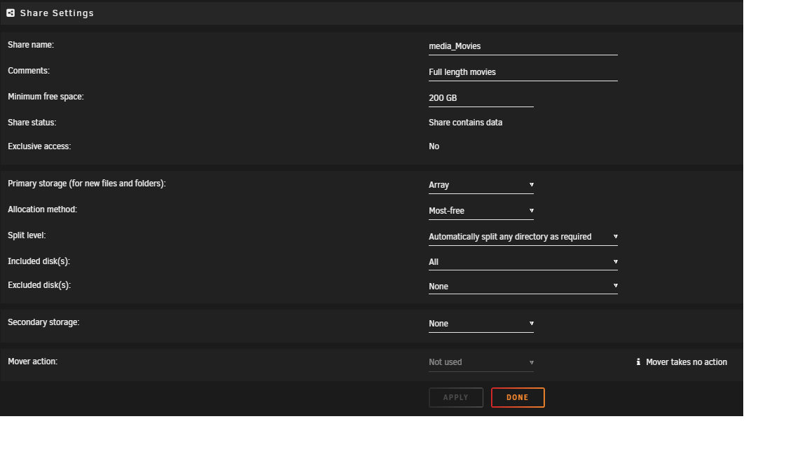

Post a screenshot of the share settings for the share you are using and new diags.

Trying a different share to move stuff to - TV shows, with a split level of top two, 200Gb minimum free and allocated by Most Free.
It seems to be working for the most part, but I do see it sending stuff to Drive 10 once in awhile, which has 300Gb free, instead of the drives with 1.25Tb+ free.
It is definitely behaving itself with moving the TV shows. It's sending the files to the drives with the most free space, while still keeping the episodes for each season in its own folder like it's supposed to.
