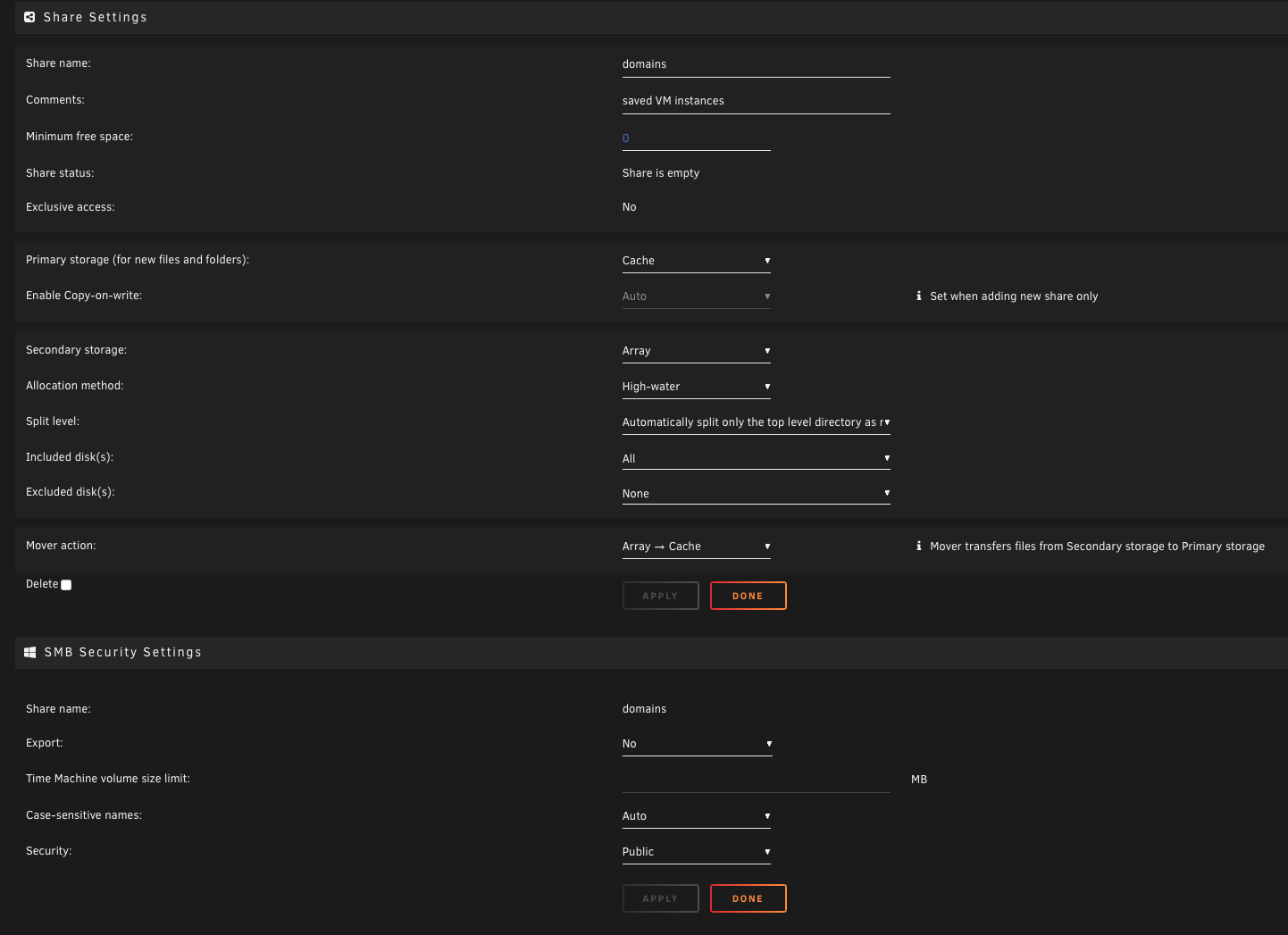

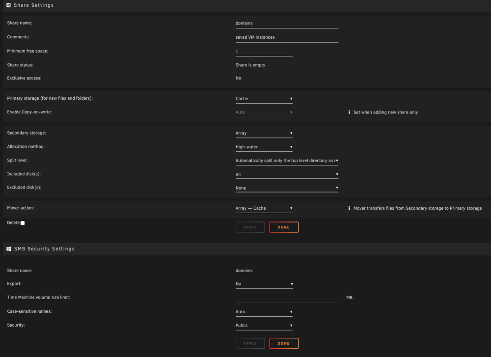

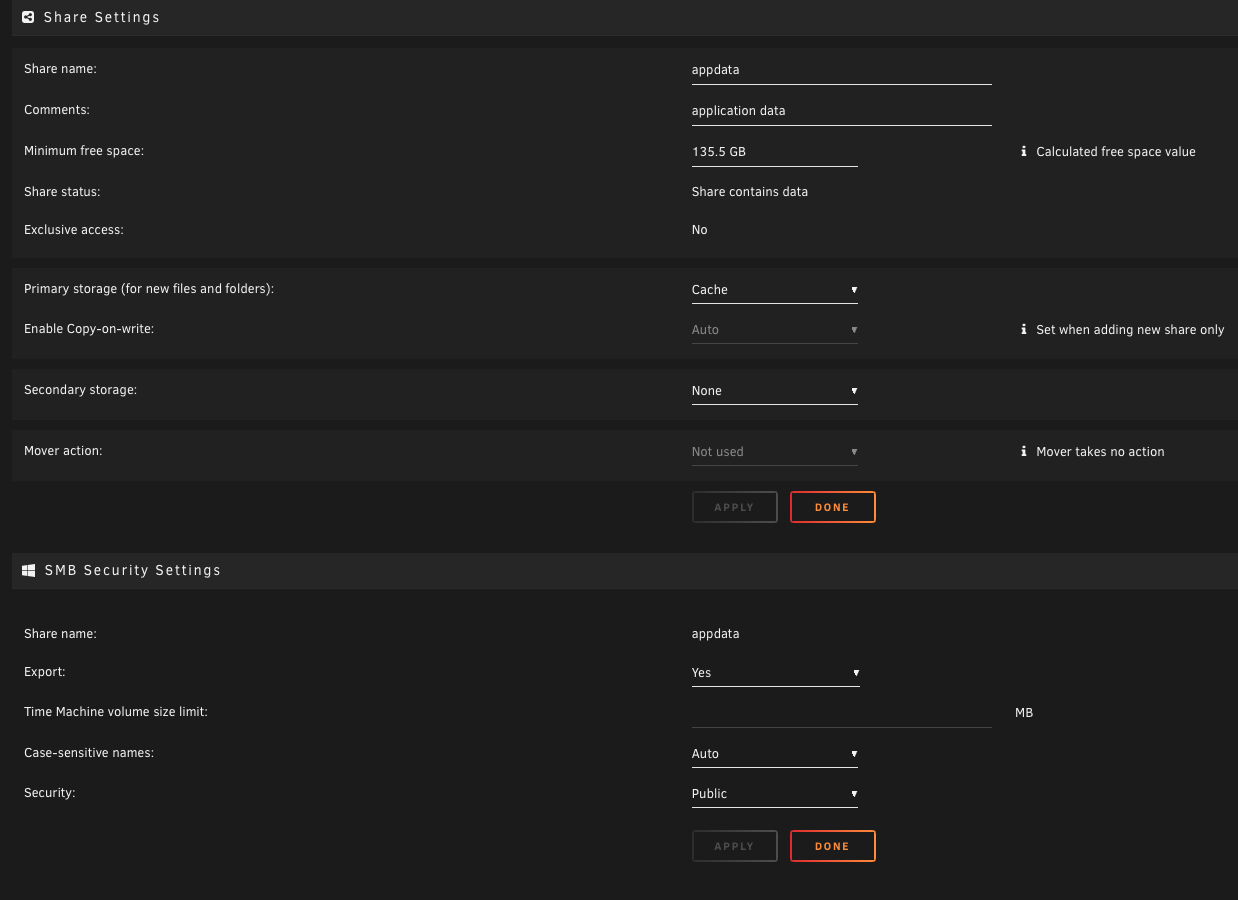

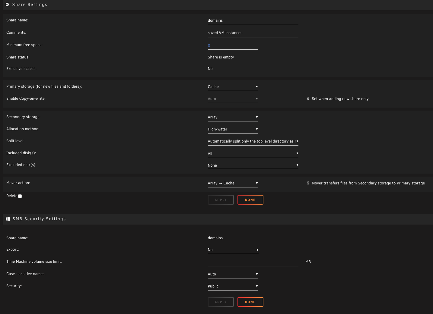

trurl Posted February 14 Share Posted February 14 1 hour ago, GatorMB said: Feb 14 09:38:02 GOLDRAID root: Fix Common Problems: Warning: Share appdata set to cache-only, but files / folders exist on the array Your appdata share has files on the array, and that share isn't configured to allow mover to move it to cache. Also, your system share is all on the array. Ideally, appdata, domains, and system shares would have all files on fast pool such as cache, with nothing on the array, and configured to stay there, so Dockers/VMs will perform better, and so array disks can spin down since these files are always open. Nothing can move open files. You will have to disable Docker and VM Manager in Settings to get these moved to cache. Quote Link to comment

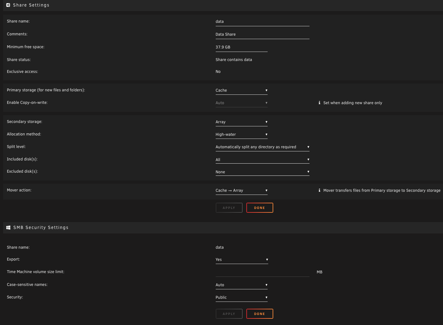

GatorMB Posted February 14 Author Share Posted February 14 4 hours ago, trurl said: Your appdata share has files on the array, and that share isn't configured to allow mover to move it to cache. Also, your system share is all on the array. Ideally, appdata, domains, and system shares would have all files on fast pool such as cache, with nothing on the array, and configured to stay there, so Dockers/VMs will perform better, and so array disks can spin down since these files are always open. Nothing can move open files. You will have to disable Docker and VM Manager in Settings to get these moved to cache. I went to the bash command and made sure all appdata / domains / system shares were moved to the cache using: rsync -av --remove-source-files /mnt/disk2/appdata/ /mnt/cache/appdata/ It moved all files. I then removed all empty folders left behind: find /mnt/disk2/appdata/ -type d -empty -delete I corrected appdata folder permissions: chmod -R 755 /mnt/cache/appdata/ chown -R nobody:users /mnt/cache/appdata/ I made sure that the appdata / domains / system shares were all now cache only in my shares menu. I made sure that the data & iCloud-drive-sync shares were all now pointing to array in my shares menu. I reloaded the nvidia driver, and installed the gpu statistics plug-in. I removed changed the macvlan to ipvlan. I have checked the cache pool and It's still pretty full (I think). I have a 2tb ssd and a 256GB ssd. Do I need a larger cache pool? What am I missing? And before I forget, huge thanks to trurl & JorgeB for all your help. I really appreciate the time you are taking! Quote Link to comment
trurl Posted February 14 Share Posted February 14 34 minutes ago, GatorMB said: I corrected appdata folder permissions: chmod -R 755 /mnt/cache/appdata/ chown -R nobody:users /mnt/cache/appdata/ That might not be appropriate for all containers. That is why there is a Docker Safe New Permissions, so New Permissions can be run while excluding appdata. Quote Link to comment
GatorMB Posted February 14 Author Share Posted February 14 19 minutes ago, trurl said: That might not be appropriate for all containers. That is why there is a Docker Safe New Permissions, so New Permissions can be run while excluding appdata. What would you suggest? Quote Link to comment
trurl Posted February 14 Share Posted February 14 Just now, GatorMB said: What would you suggest? Let each container manage their appdata permissions. Quote Link to comment
GatorMB Posted February 14 Author Share Posted February 14 1 minute ago, trurl said: Let each container manage their appdata permissions. Ok, then how would I reset it to that? Quote Link to comment
trurl Posted February 15 Share Posted February 15 There is no "reset" for that. If one of your containers seems to be broken you might have to delete its appdata and let it recreate. Quote Link to comment
