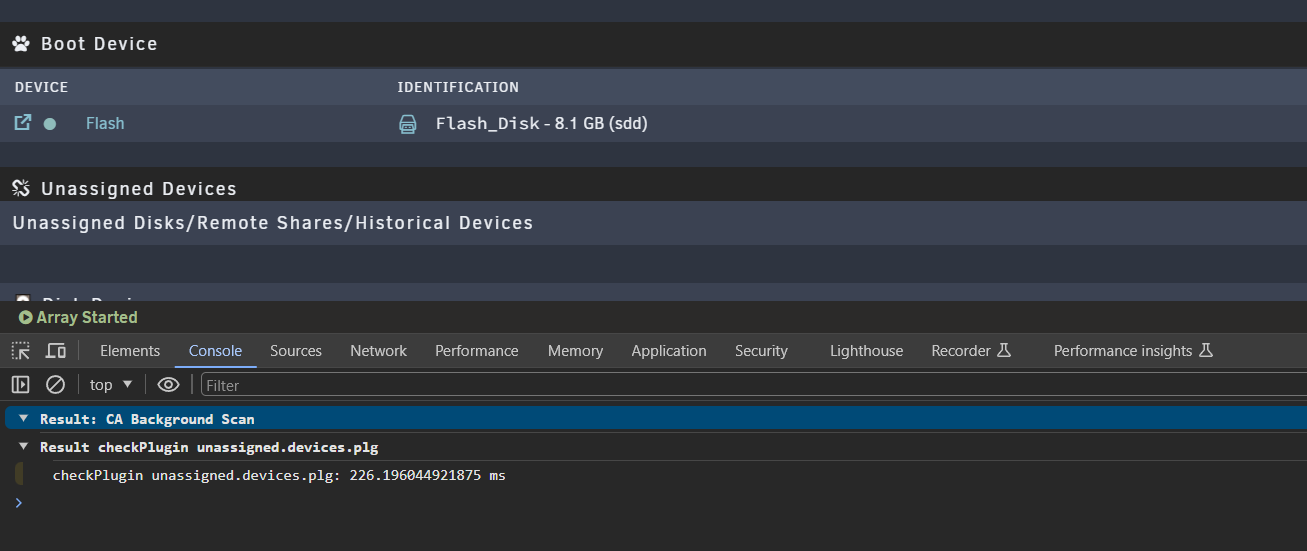

Another thing you can try is open the browser you use, press F12 if using Chrome to open the dev tools panel.
Switch to Console tab, then open MAIN page of unraid. Do you see any errors logged?
This is what mine is showing when I open MAIN tab:

Yes cleared browser data, tried different browser in and out of private modes. Disabled ad blocking ect. This is what i get in console.  image.png.36b98fba9f6270fd2d87476cadc194e7.png
