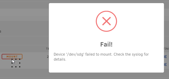

When I try to mount, I get this pop error and I am not able to proceed.  Do I need to proceed with creating a new config?
That disk was unassigned, how are you checking the fs using the GUI? You can check with UD

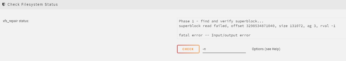

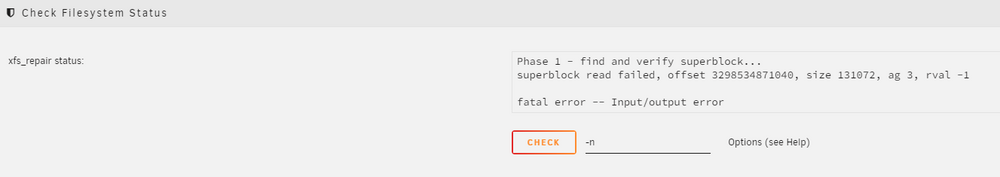

Here is the output with -n
Phase 1 - find and verify superblock... couldn't verify primary superblock - not enough secondary superblocks with matching geometry !!! attempting to find secondary superblock... ..........found candidate secondary superblock... unable to verify superblock, continuing... .found candidate secondary superblock... unable to verify superblock, continuing... .found candidate secondary superblock... unable to verify superblock, continuing... .found candidate secondary superblock... unable to verify superblock, continuing... .found candidate secondary superblock... unable to verify superblock, continuing... .found candidate secondary superblock... unable to verify superblock, continuing... .found candidate secondary superblock... unable to verify superblock, continuing... ...........found candidate secondary superblock... unable to verify superblock, continuing... .found candidate secondary superblock... unable to verify superblock, continuing... .found candidate secondary superblock... unable to verify superblock, continuing... .found candidate secondary superblock... unable to verify superblock, continuing... .found candidate secondary superblock... unable to verify superblock, continuing... .found candidate secondary superblock... unable to verify superblock, continuing... .found candidate secondary superblock... unable to verify superblock, continuing... .......Sorry, could not find valid secondary superblock
