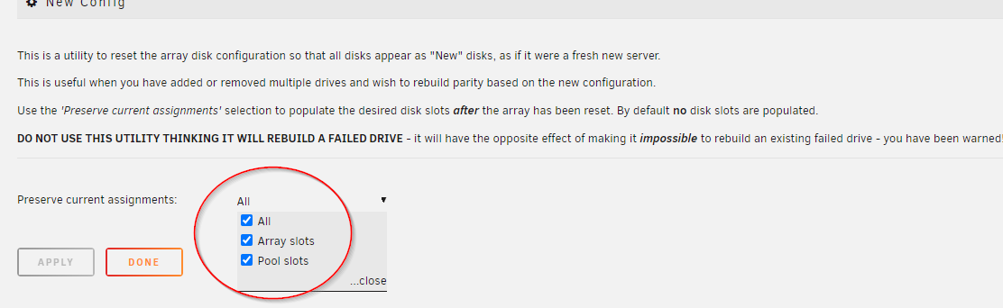

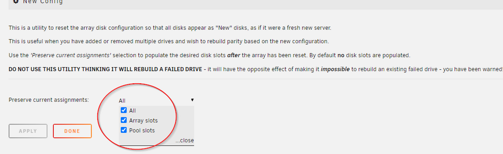

Are these the proper settings after installing the 20TB hdd for parity?
I selected All for Preserve current assignments.
Did you do the steps in the order listed? It doesn't look like it to me.
I thought from what Trural posted I should put my original 20TB hdd back as parity.  I am starting to get confused.

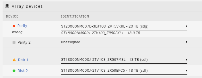

Should I put my 18TB drive back in the Parity slot? 2024-08-3110_28_27-USS-ENTERPRISE_Main1.png.97acd4cc2d293d23ace811b93c94b157.png
That screenshot suggests you did not complete New Config correctly!    Did you remember to click Apply after selecting which assignments to keep?   If you simply clicked Done then that acts like a Cancel in other OS.
