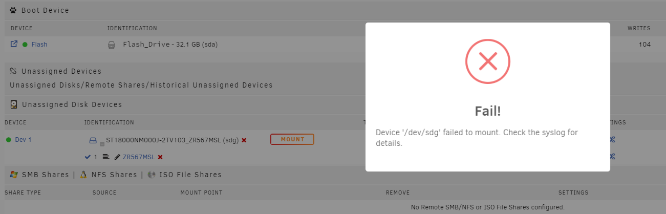

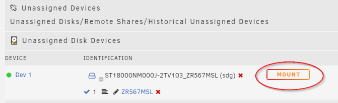

Post new diags after trying to mount the old disk with the UD plugin.
Old disk1 one that you were trying to mount with UD, is there another problem disk?

Just now, Scuba_Steve said:
I will post diags from disk 1 tonight when I get home
Just to clear, diags after trying to mount that disk with UD

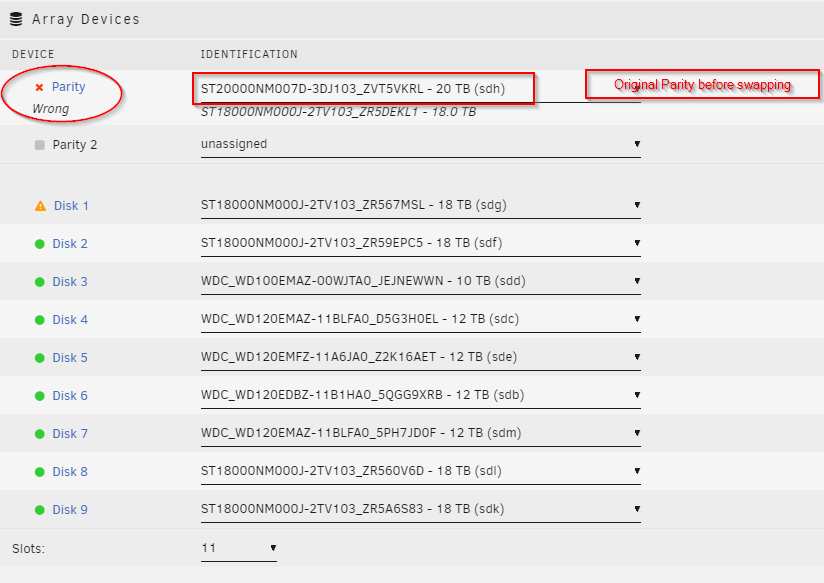

I have a question.  I think my parity drive did not rebuild properly since it only took less then 1hr and it is 18TB.  Why can I not put the original 20TB parity drive back?

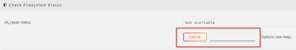

If you ran it from the GUI then make sure you run without the -n option.
@itimpi  I  ran it in the GUI without -n
Can you post the output from that?

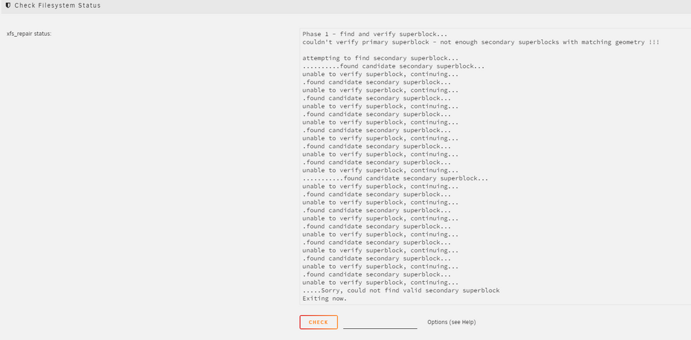

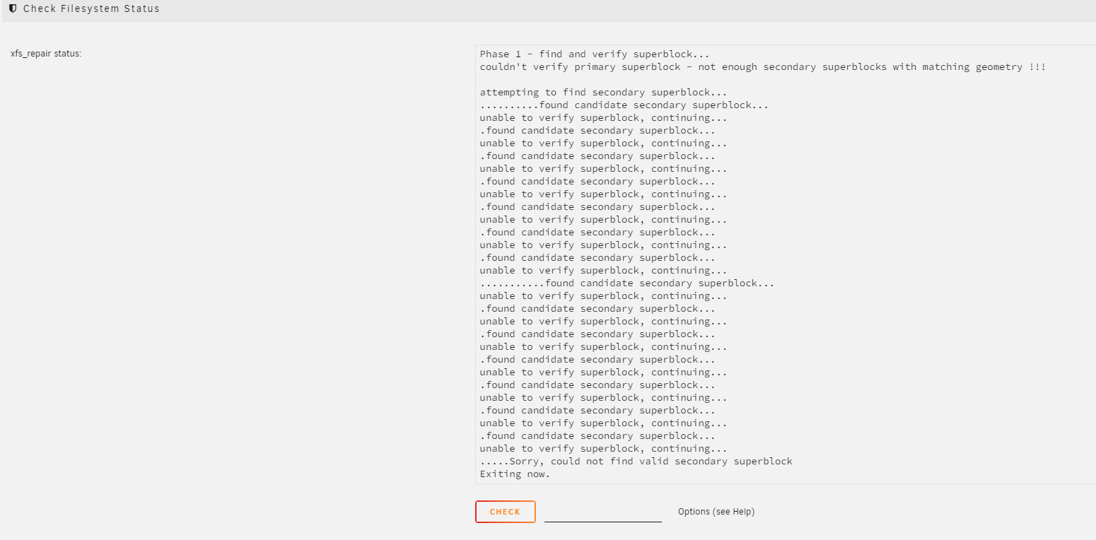

2024-08-2319_41_25-USS-ENTERPRISE_Device.thumb.png.5bfc467ebe46288d0a363fed0eb99fd2.png

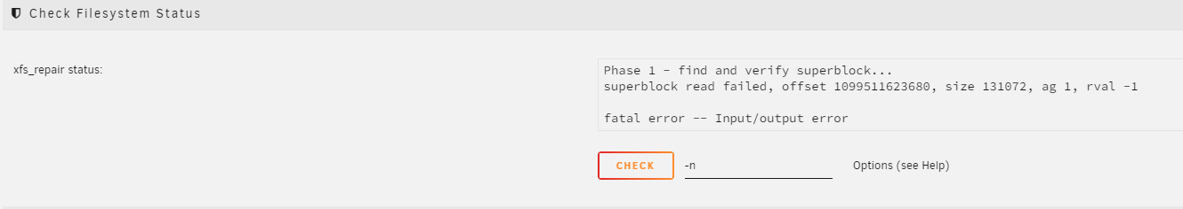

That screenshot shows you running it WITH -n.
But it doesn't matter since it isn't working anyway.
Looks like you were having I/O errors on multiple disks. Maybe a power or controller problem. If you get that fixed maybe some progress could be made.
First screenshot has nothing.  I ran it without any switches.  The 2nd screenshot is showing after I selected Check with any parameters.
I keep getting different xfs repair outputs.
Maybe we could try that. It would have to be New Config/Trust parity, then disable disk1 to see if it can be emulated.

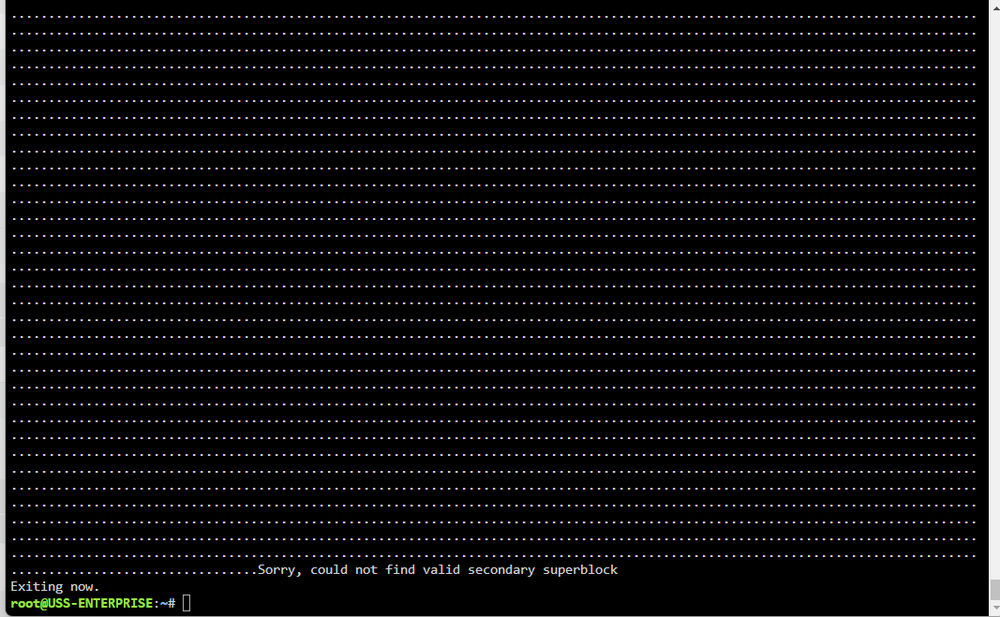

There's some confusing going on here, you are trying to mount the actual disk1 with UD, that is failing because there's filesystem corruption, but then you are checking filesystem on the emulated disk. not the actual disk, type this in the CLI and post the output:
xfs_repair -v /dev/sdg1

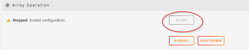

I swapped my parity back to the original 20TB drive.  Should I try and start the array?
It will not allow me to start the array.

14 hours ago, Scuba_Steve said:
Here is the output from running
That doesn't make any sense, it worked before, post a screenshot showing the start of the command.
You can't start the array because you can't change parity when you already have disk1 invalid.
The most recent diagnostics you posted did not include 20TB disk that you wanted to reassign as parity.
