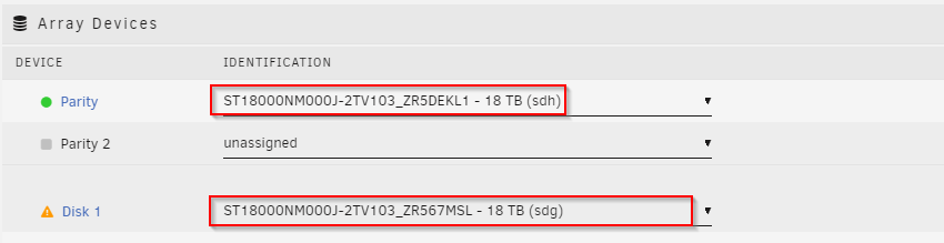

Note that if disk1 is still unmountable, rebuilding won't fix that.
@JorgeB I am not trying to rebuild disk 1. I am trying to get my array back online and working.
The current status from the screenshot you posted will rebuild disk1
I am not sure why.  If you look at my previous screenshots in this thread that is the same parity and disk 1 I have been having issue not able to start.
Disk1 is showing "invalid", this means it will start to rebuild after array start, and to be with that status, it means a rebuild was already attempted before, but it was aborted or canceled.
