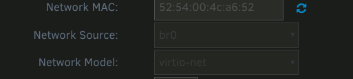

    I dont have a vHost.   I only have virbr0 and br0.

9 hours ago, Curiosity said:
the VM should be accessible at 192.168.122.115 ..., my IP address for Unraid is 192.168.212.5 and my home LAN runs in the address range 192.168.212.xxx
How are you going to access anything on 192.168.122.* from 192.168.212.* ?
In bridge mode, you should get a 192.168.212.* address (if your mask is /24)
I don't have access to the network 192.168.122.xx. I only see the IP address in the app's protocol with which IP the vm is recognized by the app

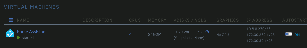

What IP is displayed in your VM row for HA on the Unraid VM page?

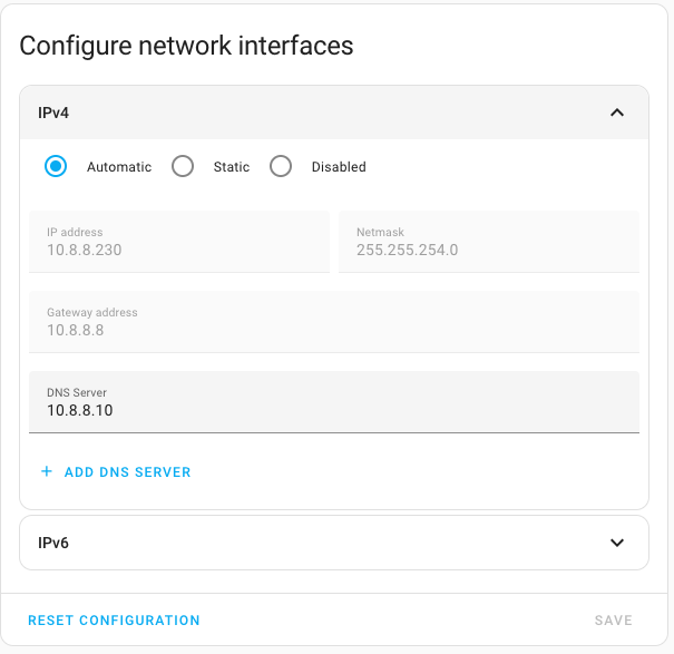

My LAN uses the range 10.8.8.0/23 (which includes 10.8.8.0 through to 10.8.9.254), and  an IP is reserved by my DHCP server as 10.8.8.230 by matching the VM MAC Address
If your VM is set up with a bridged interface (like my example below) then you must receive an IP on your 192.168.212.* range. This will be done by the DHCP server on your router. You will need to create a static assignment in your DHCP for the MAC address listed in the VM config if you want to set it to your own IP.  You can also set this in Home Assistant (see more below)
In Home Assistant, Settings -> System -> Network - you can manually specify IP/Mask etc. or set to Automatic (default)

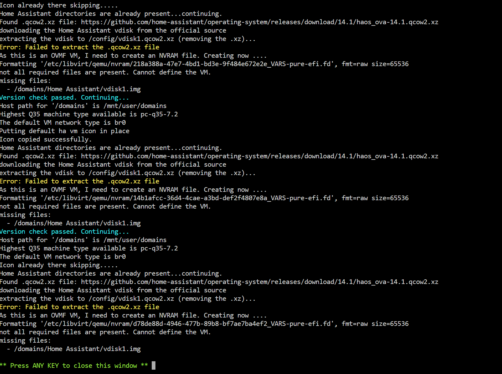

Keep getting an extraction failure. Tried restarting and redownloading the image.

On 1/8/2025 at 11:24 AM, karleksbarn said:
Using the default settings with priv.
I'm getting this same error message.
What needs to be done to resolve this?

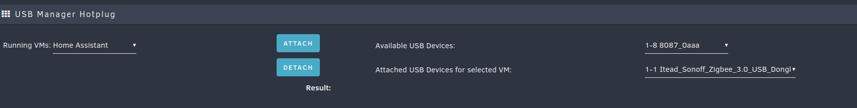

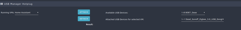

Hi everyone, I got this installed and working but I'm having trouble passing through my Sonoff Zigbee radio and my Z-wave radio. Only "TTYS0" device is showing but I get an error "Failed to connect" when trying to start it. I'm sure maybe I'm doing something wrong like not passing it through or something...
attach the sonoff at the vm ( under 7.0.1 go to vms)

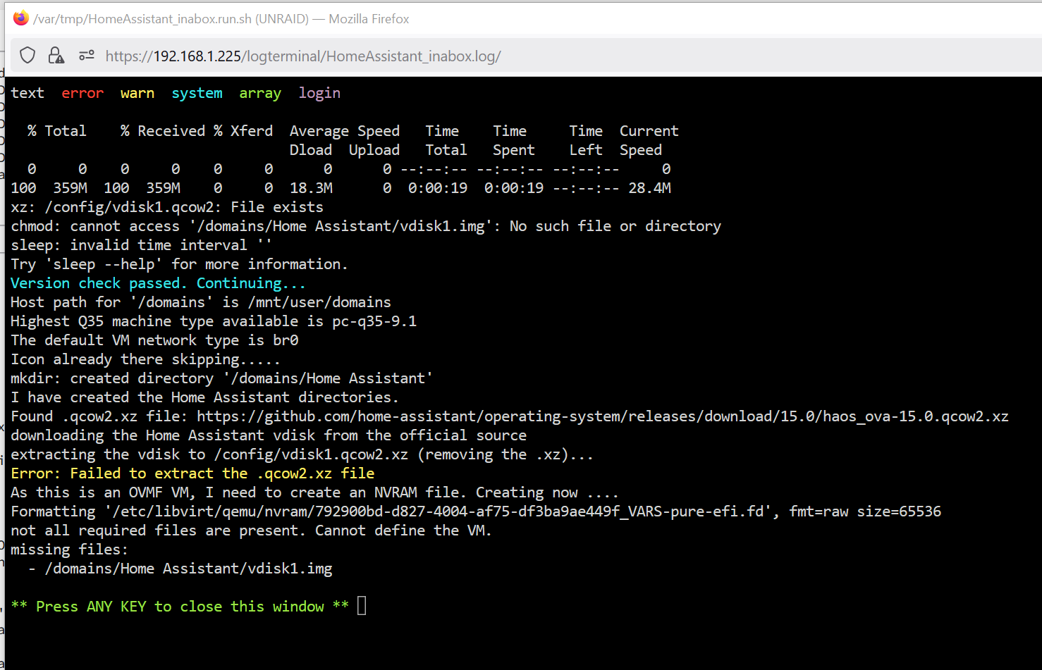

tried to install but got a
VM setup failed. There was an error during the VM definition process. and wouldn't work
On 10/27/2024 at 5:28 AM, Jorgo said:
I can't seem to get this running, Error:
text  error  warn  system  array  login
  % Total    % Received % Xferd  Average Speed   Time    Time     Time  Current
                                 Dload  Upload   Total   Spent    Left  Speed
  0     0    0     0    0     0      0      0 --:--:-- --:--:-- --:--:--     0
100  341M  100  341M    0     0  31.3M      0  0:00:10  0:00:10 --:--:-- 28.2M
/config/vdisk1.qcow2.xz: 341.4 MiB / 866.9 MiB = 0.394, 35 MiB/s, 0:24
error: Failed to define domain from /config/tmp.xml
error: internal error: Failed to start QEMU binary /usr/local/sbin/qemu for probing:
Start/autostart is disabled in VM settings.
sleep: invalid time interval ''
Try 'sleep --help' for more information.
Version check passed. Continuing...
Host path for '/domains' is /mnt/user/domains
Highest Q35 machine type available is pc-q35-9.1
The default VM network type is vhost0
Icon already there skipping.....
mkdir: created directory '/domains/Home Assistant'
I have created the Home Assistant directories.
Found .qcow2.xz file: https://github.com/home-assistant/operating-system/releases/download/13.2/haos_ova-13.2.qcow2.xz
downloading the Home Assistant vdisk from the official source
extracting the vdisk to /config/vdisk1.qcow2.xz (removing the .xz)...
Moving the extracted vdisk to /domains/Home Assistant/vdisk1.img...
vdisk downloaded and moved to /domains/Home Assistant/vdisk1.img.
As this is an OVMF VM, I need to create an NVRAM file. Creating now ....
Formatting '/etc/libvirt/qemu/nvram/0bde0555-8a11-4213-8f16-c10b571d3c36_VARS-pure-efi.fd', fmt=raw size=65536
All required files are present. Attempting to define the VM...
Failed to define the VM. There was an error during the VM definition process.
Any ideas?

On 10/27/2024 at 4:31 PM, Jorgo said:
I found the problem, I had set the generel VM settings to not autostart VM. After I changed that value, everything initiated itself correctly. Thanks for you work, @SpaceInvaderOne!
I was just able to resolve the same issue all of yall are dealing with. Here were my steps which expand on the advice from @Jorgo:
  • First head to VM Manager and set 'Diable Autostart' to Yes. Remember to hit apply.
  • Stop the HomeAssistant_inabox docker container
  • If you still have a HomeAssistant OS vm hanging, delete it and the vdisk if it asks
  • Go back to the docker tab and remove the container and image if it asks
  • Use a terminal like midnight commander or whatever you find easiest to delete the HomeAssistant_inabox appdata folder
  • Then go to the unraid apps tab > click previous > select HomeAssistant_inabox > delete (which removes the template)
shout out @SpaceInvaderOne who shared this part of the solution in the app repo's issues! I've chosen not to link there at this time so as to encourage the next few steps also be taken.
  • Now feel free to reinstall the container
    • I also suggest editing the HomeAssistant_inabox docker container's VM Images Location to a sub-directory of '/mnt/user/domains/' such as '/mnt/user/domains/HAOS/' (no spaces in folder name)
       so that way the application install doesn't attach itself to any previously downloaded .qcow2.xz files. HomeAssistant_inabox has a tendancy to look far and wide for an image to use (see reference below)
  • Head back over to VM Manager > Diable Autostart/Start option for VMs > set that to 'No' > remember to hit apply
  • restart the HomeAssistant_inabox docker and it should rebuild the VM. Be patient while the webui needs to get started after re-initializing.
Good Luck! Really hoping I didn't miss any steps I took lol
Edited by trevor4n
Thanks that solved it.

image.png.f36b9f7bab47318eb1558ad1d133ca12.pngimage.png.6b8f1989fcb4e8eff92ee5f6875b9264.png
Passing through a USB device is stupid easy.
