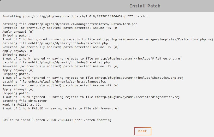

6 minutes ago, bortsampson89 said:
patching file sbin/mover
Hunk #1 FAILED at 72.
1 out of 1 hunk FAILED -- saving rejects to file sbin/mover.rej
Failed to install patch 20250128204439-pr271.patch Aborting
I get this error when installing the latest patches for 7.0. I'm 99% sure it's because I use the mover fine tuning plugin. It seems the like other patches worked, so I will ignore.
Thanks for pointing this out. If the mover tuning plugin has already modified this file then this will generate an error. Should be ok to ignore, need to see if we can improve this

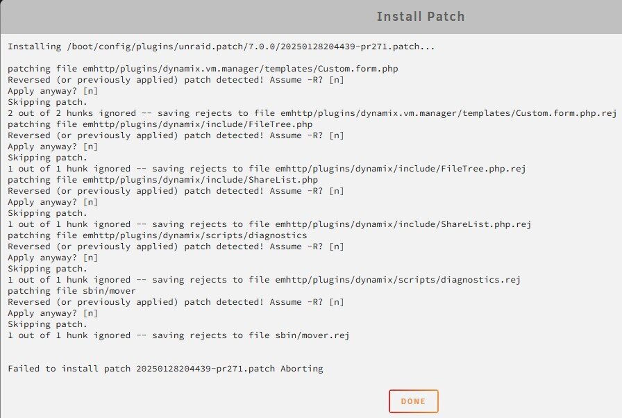

Hello,
Attempting to install the below set of 'patches' via the Unraid Patch plugin:
Generated the following error:
Immediately retried the same process and received the below error:
Rebooted unRAID Server and retried the process, received the following error:
(Reviewed the 'Unraid Patch' Support Forum and saw some issues with the Mover Tuning Plugin.)
Removed the Mover Tuning Plugin:
Retried applying patches and received the following error:
(Diagnostics attached.)
Please advise.
Thanks.
littlebox-diagnostics-20250131-0935.zip
Edited by PPH
Added diagnostics file.
A reboot would have been necessary.  We are popping out an update to the plugin in a couple of minutes
On today's update the issue with mover tuning is mitigated.
During a reboot of the server, the patch plugin will install first before any other plugin.  This allows it to patch the files as set by the OS instead of attempting to patch a file which has been modified (or replaced) by another plugin (eg: Mover Tuning)
If a patch fails to install via the GUI, then a reboot will be suggested to perform.

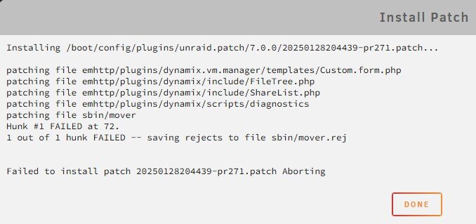

Using mover-tuning
Saw the new patch plugin update install failed.
Rebooted as it told me to do.
Went to plugins and there was a new update for it again,
try to update same error about reboot.
Will try rebooting again.
Ok second reboot got it to update 🤷‍♂️
Hi @Squid,
Updated to latest version of unRAID Patch plugin and also rebooted my Server.
Plugin now working without issue:
Thanks for your help.
Yeah, that was my bad.  @ljm42 and myself went through a ton of testing yesterday via a different .plg file and when I did the release this morning, muscle memory dictated that I simply updated the changelog and MD5 in the "normal" plg file and not the one which we were testing -> hence the need for the quick second release.
@Squid Thanks for the clarification 👍
