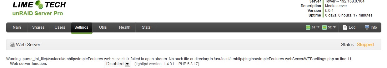

I just tried the WebServer for SimpleFeatures and get this error just like others :
Warning: parse_ini_file(/var/local/emhttp/simpleFeatures.web.server.ini): failed to open stream: No such file or directory in /usr/local/emhttp/plugins/simpleFeatures.webServer/WEBsettings.php on line 11
Web server function: (lighttpd version: 1.4.31 -- PHP 5.3.17)
I have read the previous threads but don't under the fix. Can someone explain this in baby steps?
Using 5.0.4 version with all other simplefeature working correctly.

Thanks for the suggestion but the issue is persistent. Also I can't make any changes to the Web Server settings.
See attachment
