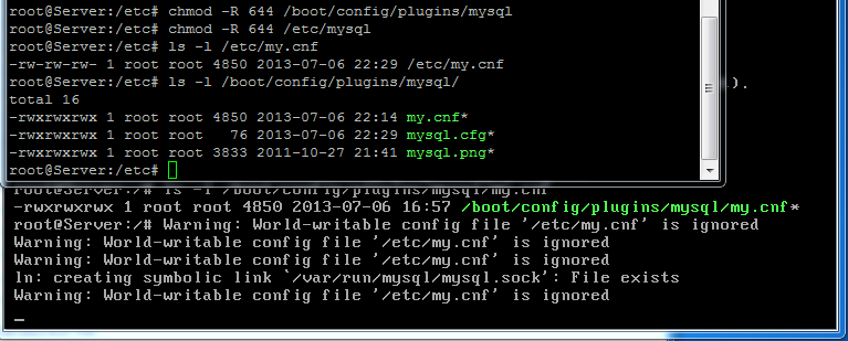

Hi guys - quick question regarding mySQL: When I start this program I get the following error:
Warning: World-writable config file '/etc/my.cnf' is ignored
I've gone through and done:
chmod 644 /boot/config/plugins/mysql/my.cnf
but when I do an ls -l on that file I don't see it changing permissions. I've also done the chmod 644 on /etc/my.cnf but I still get that error.
I had an issue where the USB drive was Read-Only, but I've since loaded it to my Windows PC and had a ScanDisk run on it since, and it appears to be working again (I can add and remove files and edit them).
This DOES NOT show up in Putty, just on the console.
The included picture shows the top window, which is PuTTy, where I performed the CHMOD commands, then an LS -L. The bottom window shows the errors I run into when I "Enable" the MySQL plugin.
Things work - I just have a lot of spare horse-power on this server and figured I'd increase a few settings to see if it made a difference.

So I believe you would want to change the boot/config/plugins/mysql/my.cnf because it gets copied over to /etc/my.cnf
I try changing that file, but the permissions stay exactly the same. I've gone through CHMOD on the PuTTY command and through MC's CHMOD option, nothing changes it.
Isn't that because /boot is a FAT32 file system and Linux file permissions aren't applicable there?
You would probably need to edit the section of the plugin highlighted by thedude459 and add the chmod command after the line which copies my.cnf to /etc
Exactly, you can't chmod the flash file system. It should use that file, my install does. I turned off the logging, which was taking a huge amount of space on my cache drive.
That makes more sense. Like I said - it shows up only on the console itself, not in my PuTTY session nor my log from what I can tell so maybe I'm just looking too far into this (especially if it is working for everyone else).
That's the piece that I've been hunting for. The MySQL plugin is giving me the same world-writable error. I removed the /etc/my.cnf and restarted MySQL which puts it back with 666 permissions. I think I'm missing something in the editing of the plugin.
if (file_exists("/boot/config/plugins/mysql/my.cnf")) {
      unlink("/etc/my.cnf");
      copy("/boot/config/plugins/mysql/my.cnf", "/etc/my.cnf");
      exec_log("chmod 600 /etc/my.cnf");
    else {
      exec_log("cp /etc/mysql/my-medium.cnf /etc/my.cnf");
      exec_log("sed -i -e '/^#innodb_data_home_dir/c\\innodb_data_home_dir = '$DATADIR'' /etc/my.cnf");
      exec_log("sed -i -e '/^#innodb_log_group_home_dir/c\\innodb_log_group_home_dir = '$DATADIR'' /etc/my.cnf");
      exec_log("sed -i -e '/^#innodb_log_arch_dir/c\\innodb_log_arch_dir = '$DATADIR'' /etc/my.cnf");
This looks correct to me, but when I restart MySQL, the /etc/my.cnf file still gets put in place with world-writable permissions. Clearly I'm missing something. Has anyone got any advice on what I'm doing wrong?
Nope, my bad. The change to the plugin worked fine, but it requires the plg to load when UnRAID starts. Simply restarting MySQL wasn't sufficient. Now my changes to the my.cnf are applying correctly and my MySQL performance is more like it should be.
