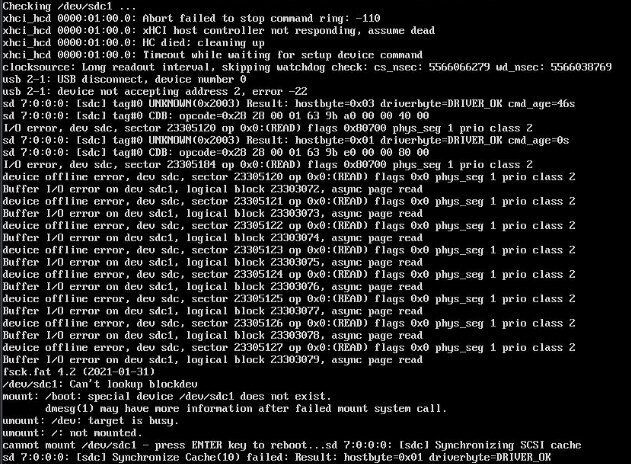

Description:
I recently updated my Unraid server to the latest version, but upon reboot, the system fails to start. The boot process halts with errors indicating that the xHCI host controller is dead, followed by the USB drive disconnecting. Ultimately, it fails to mount the boot partition with the error mount: /boot: special device /dev/sdc1 does not exist.
Troubleshooting Steps I've Taken:
  1. Changed USB Ports: I tried plugging the boot USB into different ports (both USB 2.0 and USB 3.0), but the exact same error persists.
  2. Checked USB Health on Windows: I plugged the USB flash drive into my Windows PC. The drive is fully recognized, and I can read and write files without any access denial or errors. It does not seem to be a physical hardware failure of the USB drive itself.
It seems like there is a kernel/driver conflict with the USB controller occurring during the boot process after this recent update.
System Information:
  • Previous Unraid Version: 7.2.4
  • Updated Unraid Version: 7.2.5
  • Motherboard: ASUS PRIME B550M-A
  • CPU: Ryzen 4650G
  • RAM: DDR4 Samsung 32G*2 + 16G*2
  • USB Drive: Samsung 64GB
Error Log on Screen:
Does it still start if you revert to the previous OS?
Does it work if you boot with 7.2.5 with a stock install, without restoring any of your config?
