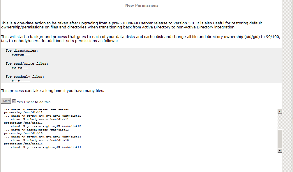

Tom, there seems to be a bug with new permissions and the unRAID web page, I have noticed it since at least 5b12a and even in 5.0-rc6-r8168-test2.
To reproduce. 1 parity drive, 1 cache drive, 15 data drives (from Disk 1 to Disk 15) many TB of data on the data drives. Once you click start, the weg gui will display permissions being set on:
cache

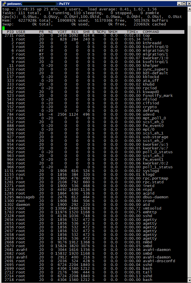

and then stops displaying any more (after these 7 disks). Via terminal using Top I see chmod and chown still running. Counting how many times chomd followed by chown run before these processes stop does NOT equal the total of 15 disks.
Can this be looked into and somehow fixed for the Web GUI or have this logged in the syslog if the GUI is to much trouble? As everyone should know that the function did successfully complete on all disks.
Update: Confirmed, via terminal, lsof | grep chmod (and chown) I was able to follow which "next" disk new permissions ran on. It moved on to disk 15, disk 2, disk 3, and moved to disk4. Seems to have crashed on disk 4 as I was waiting for chown to appear via 'top' and it disappeared and varies new processes appeared and are not going away. Syslog shows nothing during the running of new permissions. Nothing running or connected to the unRAID server. Also access to web interface no longer available (The webpage cannot be found). Via terminal I was able to issue a 'powerdown' command and gracefully shutdown the unRAID server.
2 Screenshots attached, one showing the webpage always stopping to display updates after disk 14 and second screenshot of the processes running after the crash.

Update:
Using 5RC8a, no change, web page stops displaying progress of new permissions running. No guarantee it completes.

With 5.0RC9a, the new permissions completes successfully. Via the new browser window, it hangs at first, but if left alone it eventually displays the new permission status and its progress in its entirety.
17 Drives: completed, elapsed time: 00:24:41
Good job Tom!
Good job Tom!
The window is not 'hanging', the script is simply running without outputting much text.  First iteration of this script used 'find' to traverse the directory structure of a disk to change the mode and owner, outputting the directory name for each directory.  However, for large numbers of directories this causes the web browser window to become enormous while also slowing down the operation by an order of magnitude because each line being sent to the window is actually a javascript call.  Anyway, programming for output going to a web browser window has some limitations you don't see with something like, e.g., a telnet window.
Most important is it works and waiting on the output is no issue, here  ;)
