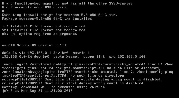

Started to work on resolving some 6.1.3 problems. I have a question for you guys/girls using the proftpd plugin. Is anybody of you using the config editor or do you manually edit the proftpd config file in shell? The config editor would only work if you have a webserver installed directly on your unRAID system. (Running the webserver in docker will not.) As this is rather complicated, I believe it to be broken for nearly anyone on >6.1 at the moment. As I did not get any questions regarding it, I guess it would not hurt to remove it altogether to simplify things. Any Objections?
Having just updated to 6.1.3 non-beta today, I hit the same prompt as it looks like others are getting, but I think I know the issue.
The problem, it seems, is that you moved where it's looking for scripts. Before this update, there was no scripts folder, and subsequently no folder created. I tried moving the mounting/unmounting files there, but that's only part of the issue. The install is also not putting the rc.ProFTPd file in scripts either (it's not saved anywhere in the config folder). So any of those files can/are throwing errors.
@scooterpsu:
Can you describe your update process?
You were on unRAID 6.0 and had the old plugin version. Then you upgraded the plugin and then unRAID. Or unRAID first and then the plugin? I'll need a little bit more info on what to check.
If you remove the plugin and reinstall it, it should work on 6.1.3 already. I have moved the script files to the proper locations.  What needs to be fixed is moving the mount/unmount scripts automatically on update. This does not happen correctly yet.
