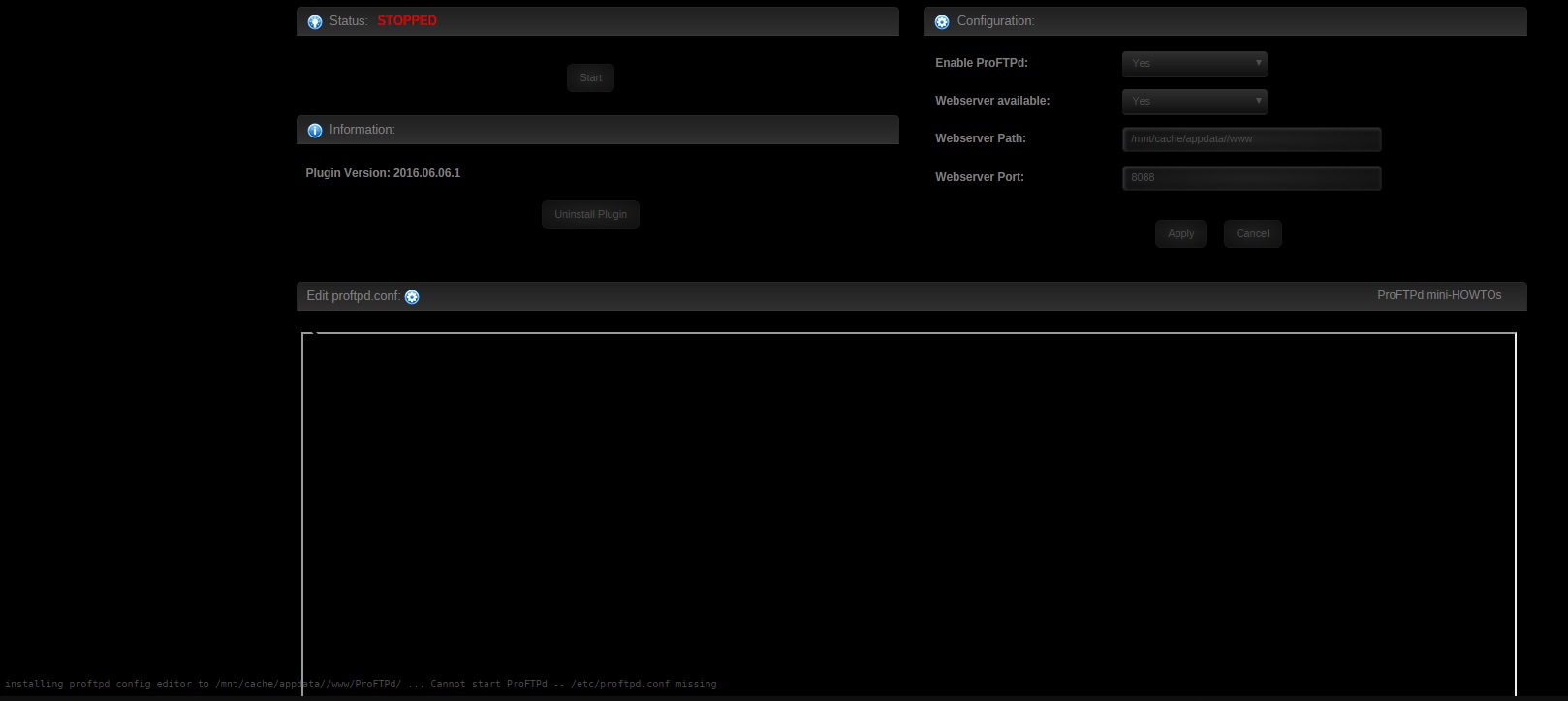

Hi, Im having some problems getting the app to run and wouldnt mind some help. :)
I have Apache installed and working with no problems.
When I try and start Proftpd it keeps coming back with an error on the bottom of the screen as seen in the pic.
Any ideas what im doing wrong?
Hoping its a easy fix as im not overly smart when it comes to using telnet.

I am using the apache-php docker and getting errors when trying to edit the config file. It is looking for a proftpdce.php file that does not exist.
This happens after selecting Check & Save.

@MickMorley
I tried to use the docker apache when it was made available and I failed, too. I'm using the plugin version now and that works fine. I believe the reason why the dockers fail is, because they block access to files outside of the defined web folder for valid security reasons. Sadly this is something the config editor needs to work, as the proftpd.conf is in /etc/ on your unRAID.
If you don't want to use the apache plugin instead, please disable the config editor. You don't really need it. You can always use nano in a console to edit the proftpd.conf or use winscp if you like a more graphical editor. Don't forget to restart the service afterwards for the changes to get applied.
On a side note, you seem to be using an older version of my the proftpd plugin. The config editor has been renamed from proftpdce.php to ConfEdit.php. You should not get the old name with the newest version. If you are using the newest please tell me, I'll have to recheck the source code, then to make sure I did not miss some old reference in there.
Edited by SlrG
spelling corrected

@SlrG
Thank you for clarifying.  I tried to search this topic for the keywords but couldn't find anything.  I double checked and I am using version 2017.07.12.  I just installed it yesterday.  ConfEdit.php is being populated on the Apache webroot folder but it looks like there are still references to the old variables.
Okay. Thank you for the information. I'll try to fix the error and release a new version soon. It will still not work with the docker apache versions however, as I don't know how I could possibly fix that.
@MickMorley
The bug should be fixed now. Please update the plugin and delete the ProFTPd folder from your web server directory. Then restart the service and the fixed editor should be saved into your web server directory. Thank you very much for finding and reporting this bug.
