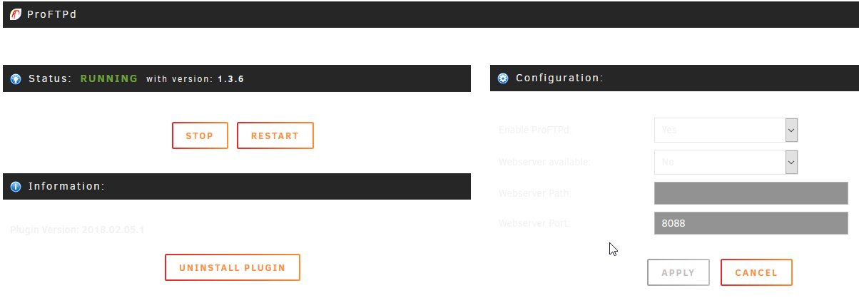

I just updated to unRAID 6.6.0 and the proFTPd settings page is a bit unreadable. I don't know if it's on your end, @SlrG or if it's something to do with @bonienl's excellent new WebGUI, but they're not playing nice together:
1082012259_2018-09-2419_25_30-NAS_ProFTPd.thumb.png.e22c4247193e0e55319fae487448ac3d.png
By highlighting the text, of course, I was able to read it all and duplicate the settings from my primary server to my new backup server.

@FreeMan
I'm still on 6.5 on my server, so I did not notice the problems until now. Thank you for reporting. I'll have a look and try to fix it.
