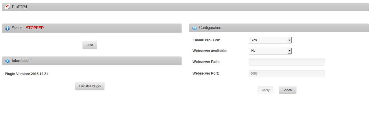

58aad7fdc828d_2016-06-19_00_55_51-_Tower_ProFTPd.png.1a694a13bed5c2f4b21fde7a00e9835c.png
The config page looks fine so far. So I guess most things of the plugin install properly. Please post the log from Tool / System Log. It might be large and will need to be zipped in order to be attached.
