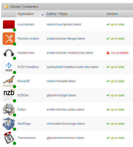

hey smdion,
your headphones container isn't having much lucking in the auto-update notification department.  Here's a screenshot.  I've deleted and reinstalled with no change.
hey smdion,
Working for me mate. Although only installed it today but checked for updates and it looks like it's working
hmmm, odd.  I trashed everything and started again when I upgraded to 6.14b and I still have the issue.  Must be something at my end...
OK, scrapped everything for headphones, including my xml templatre and restarted. Seems to work fine now
