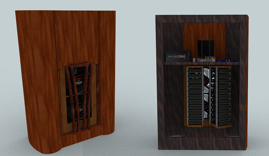

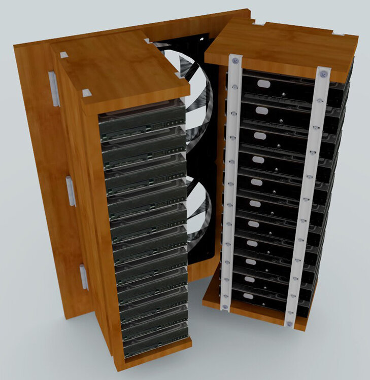

Here is another render. Gonna go mock it up before I buy some hardwood to cut out the box.

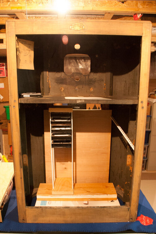

Update: I should be back on the project starting this October.  Did a quick mock-up of the last render I did, and found that the back bracket between the radio side and the drive cage is nearly inaccessible. Might be hard to mount new drives.
Looking at using lift off hinges
Each side will weigh between 18-20 lbs (when full). The hinges must be able to handle it.
This would allow easier removal of the cages for new HDD install/replacement.
Might try a few new designs.. but I like the current hinge design.
Would have used drawer slides on top (so the cage slides back), but getting them short enough will be tough.

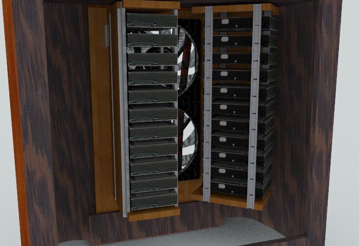

There is going to be a redesign of the way the racks open. They will pivot back from the bottom.

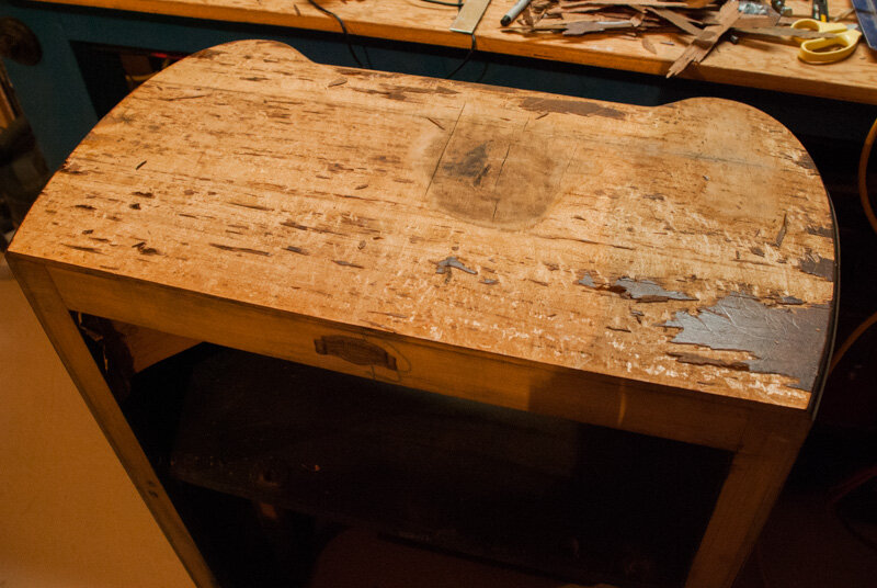

Here is the damaged top again:
Removed the top damaged layer of veneer. Going to go veneer hunting (saved large piece for grain matching)

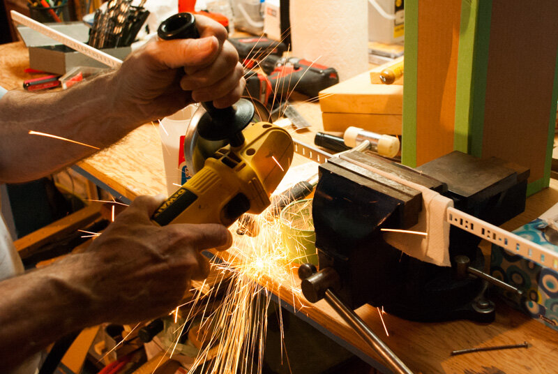

Cutting the shelf brackets.
Rough idea of height / clearance requirements (mock up using pine. too soft and not quite cut to spec. Slight bends in the brackets). Solid though.

All for now. Gonna have to go back to Sketchup for a new pivot design.

Some bumps in the road I need to tackle:
1) How to get the power and data cables past the motherboard shelf.
      a) I am thinking of making a back for the radio using 1/8th  inch backerboard. Cut holes like they used to in the old days to hide the cables running down the back. But I would know it's messy back there.
      Use velcro to hold in place (no damage)
      b) Cutting out one corner of the midshelf (break my promise of no damage).. but it's inside and would not affect any mounting of original equipment.
      c) Start making custom data and power cables (cables will fit, connectors won't clear the hole)
2) Existing cables are too short to make clean runs.
      a) Make custom cables that would appear to look like old phone patch chords
      b) Keep standard look and buy longer and just route cleanly.
3) Rebuild motherboard wooden adapter plate (curved issue)
4) Fan Controller Location (18inch temp leads)
5) Power Button / Magic Eye Decision
6) Using the original glass dial face in some fashion.
7) Power Supply positioning. (will depend on cable / routing decision)
8 ) To pivot or not pivot the racks. Just simple pull out? Need lock pin ideas.
9) Fan/Speaker location covering. Can't use speaker cloth. Air won't move past it easily. Thinking of perforated sheet metal.

There was no restoring the top veneer. Fully split, cracked and water damaged (flower pot on top?)
Previous owners stored it outside in covered sun room (no humidity control)
