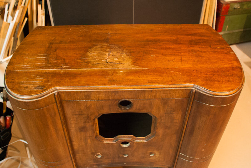

4 Holes. (5th top is reserved for magic eye). What to do with them? There was missing a wooden radio dial when I bought it so I am one short (of the small ones).
You can use them to for FAN SPEED knobs - but then you run the risk of people messing with your airflow..
Maybe you can place a working AM/FM transistor radio inside and set-up the knobs to control it's Power, Frequency, Volume, FM/AM - thus you will have a server and a radio all-in-one  ;)

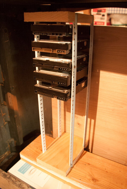

Here is a little bit of an update.
The server is running great. Temps are stable.
Added a 3/4 inch plate to the bottom with felts underneath. Slides nicely on the hardwood floor. (Nearly too heavy to lift alone)
Items to tackle:
NEW
Vibration from 1 or 2 older drives is resonating withing the case. (1 of them is VERY loud)
EXISTING
- Veneer the top
- Find front cover material (perforated aluminum sheet) or maybe wood veneer for matching?
- Complete the back panel
- Find Radio Component that will work in radio and make custom knobs (was missing 1 when I bought it, want all to match)
- Work out glass display functionality (worries me, I can't remember where I put it >.<)
- Power Button. Screwdriver is annoying.
