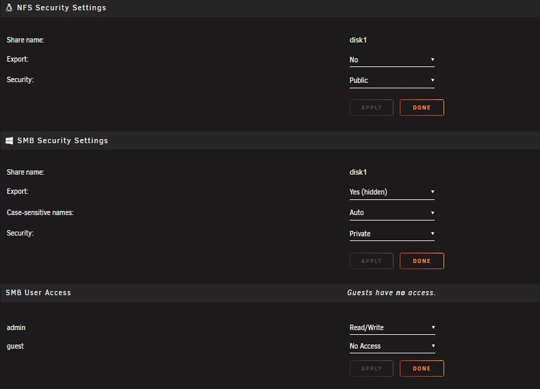

  Now I have my disk shares working again for my 6.5.3 test server, I am looking for a way to have them enabled, but hidden from other users casual browsing... is this possible with 6.X, or did it vanish sometime between 4.x and 6.x?
  Also, as some have said, this is NOT a bug really.  It is just a misunderstanding of file system operations.  Just like you want to avoid recursive loops, unless you are cautious with what you are doing, you really should not be playing around too much with virtual directory structures, again without proper thought put into the potential issues that could result.
  I think in general the decision to disable disk shares by default was a very good choice.  It will help protect the majority of casual computer users, that are more frequently adopting Unraid as a home server solution.  At the same time, I do not see that Unraid would be very useful to me, or at least fully meet my needs, without the ability to use Disk Shares!
  As a side, but related note, I always move files from a networked computer, using the DISK SHARES, (obviously since my user shares are set to read only).  I use a combination of Drag and Drop, Command line, and Batch files.  If moving a file or sets of files to another disk share, I make copies of the files to the new destination first, then I do a full file comparison of the original and new copies.  Then and ONLY then do I delete the original file from the original disk share.  I am a bit paranoid about potential file corruption, so I take the extra steps to insure it does not happen while the files are being moved due to memory, disk, or even communication losses.  If I am moving a file WITHIN a disk share, to another user share that is also on that disk for example, I just do a simple move as it does not do as much to the file in the process, but perhaps I should re-think that one, as some OSes do more than others at that point.
You can set the Disk Shares SMB Export option to “Yes (hidden)” to stop them being visible on the network but still accessible if you know the name.
Yes!  :-)  Thanks!  Just what I was looking for!  I think that was the last thing I felt I needed before full deployment!

OK.
I have all 11 disk mapped within windows. I use this to manage the disks accordingly. I can hit any disk and see the data
the disk shares are exported (hidden) for admin user only

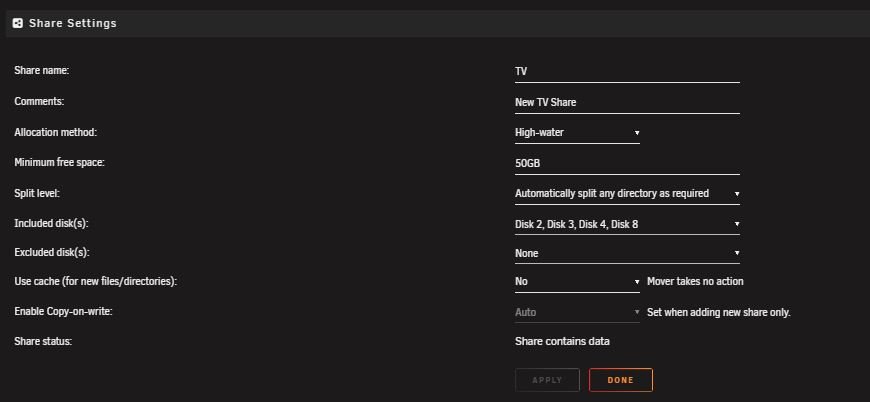

I have made a new /user/share:
/user/tv/
Right now, I am moving data from the 3 shares to the one share. Once moved, I am eliminating the 3 shares. Basically I am consolidating data and re-organizing my shares.
I suppose I want to be sure I am thinking about this the correct way so I am not setting myself up for data loss at all. I do believe I am on the right path, however the UnRaid community are some of the best people to give opinions and provide outlooks at times questions come up.
Thanks :-)

When I was using:
/mapped driver letter/disk8/ -> user/tv/
you had stated that was a 'neddy-no-no'
I didn't move much data at that time or media i really didn't care about. Via Windows, I then opened 2x windows
/user/tv-sd/
user/tv/
Did a cut + paste, and data is starting to move.
I really think this would be much faster via command line, however, I need to brush up on my unix skills 😞
