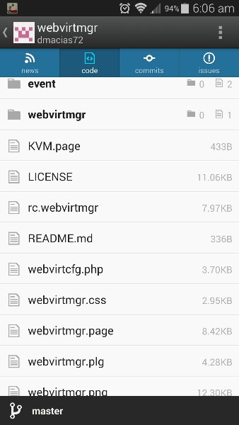

Here's a screenshot of what my webvirt git looks like.  And the plg.  Packages are in a separate repo.

Can't read your plugin.  There are no line feeds.
Are you using a viewer/editor that understands Linux end-of-lines?
Yea the current repo tends to go down once a week at least for maintenance :)
Thanks for the input
