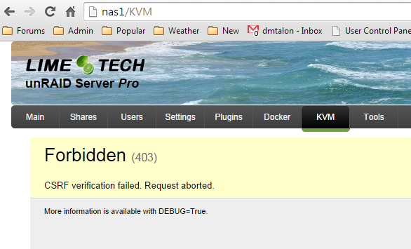

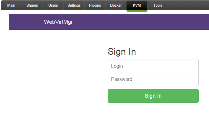

With the latest plug-in update it's not allowing me to log in.  If I goto unraid:8000/servers/ I can log in and it works.
I changed it to use ip from unraid network cfg.  If you try ip:8000 does that not work for you?
If I click on the running green icon in settings/kvm Manager it works which takes me to http://192.168.0.100:8000/servers/
If I click on the link in unraid gui (KVM across the top) it won't allow me to log in.
edit: If I use http://192.168.0.100/KVM it does work.  But everything i do in unraid is with my dns name nas1
I've had this issue recently as well and it had to do with network.cfg on the boot device having an IP address defined even though it was set to using dhcp.
