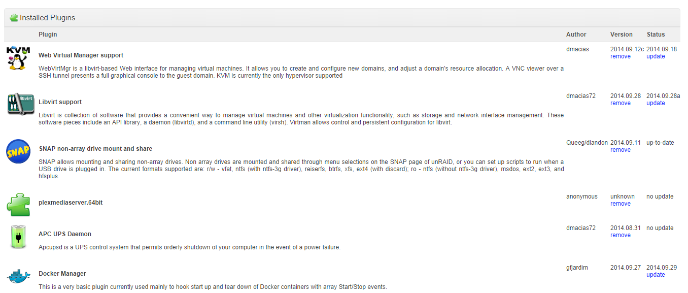

I've got the beta10 version of libvirt plugin installed, and the 2014.09.18 WebVirtMgr installed with Beta10a.
When I restart my unRAID server, both virtMan and VM Manager show up in the Settings with a status of "Stopped".  I thought both were supposed to start during boot, as I don't see any settings for autostart.
Am I correct in thinking something is wrong because these plugins aren't starting?  If so, any suggestions on troubleshooting?  I do not so any errors in the log.
The only thing "special" I can think of is I am mounting /mnt/btrfs (an ssd drive) in my go script, and pointing WebVirtMgr there instead of to my cache drive.
I rebooted onto 10a w/o updating the two plugins that seem to be showing updates.  And everything started all the way up (libvirt/webvirtmgr) and my VM booted.
I see this in plugin's though.  Is it ok to install these updates?  do I need to make any configuration changes?
The virtMan update isn't really necessary.  I just change the way I renamed the old virtman to virtMan.  Webvirtmgr has some changes.  I added a login page if you scroll down in the settings page and a few minor changes.  But I'm gonna update it tonight to a new install format.
