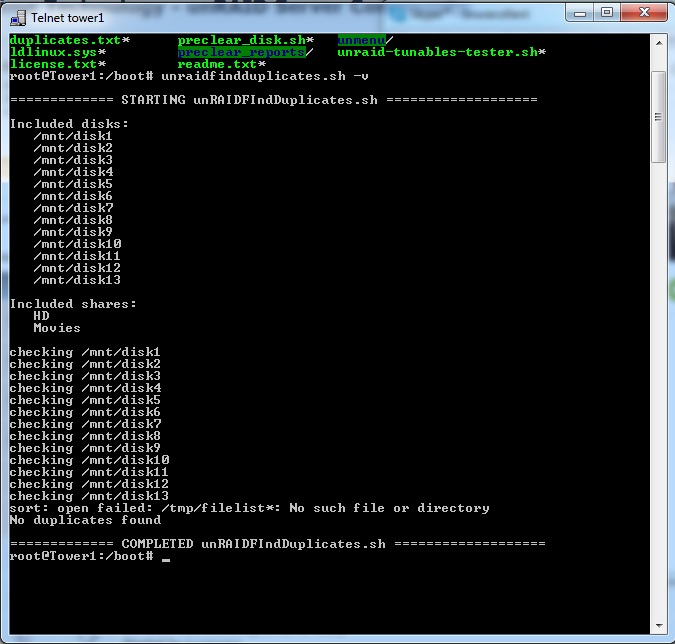

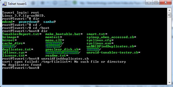

Getting 2 errors. Anyway to fix this?
./unRAIDFindDuplicates.sh: line 153: [!: command not found
and
ls: cannot access /mnt/disk*//mnt/user/.........
Please see attached.
Duppie
The first error is cosmetic and can be ignored if your parameters are valid (it is an error in parameter validation).
Not sure what might cause the second one.  Can you give me an example of the command line used so I can see if that is relevant.  My suspicion is that you gave an incorrect parameter and because of the first error did not get warned about it correctly and the run aborted.
I am testing a new version with some additional parameter options (added as a result of feedback) so now is a good time to fix any errors in the core code, and also improve validation of any parameter options.
I also get an error
The only way I can see that error being reported is if there were no files found (the current logic assumes this is not a possibility)!  Can you try running with the -v option as that might give more information.
It's a huge share and it finishes immediately, quicker than even spinning up the disks, there are definitely duplicates, I will try it with -v
here you go
and
Duppie
For the 2nd problem use the command line option '-i Movies' rather than '-i /mnt/user/Movies' ... The /mnt/user is automatically added to what is supplied to the -i parameter's value.
here you go

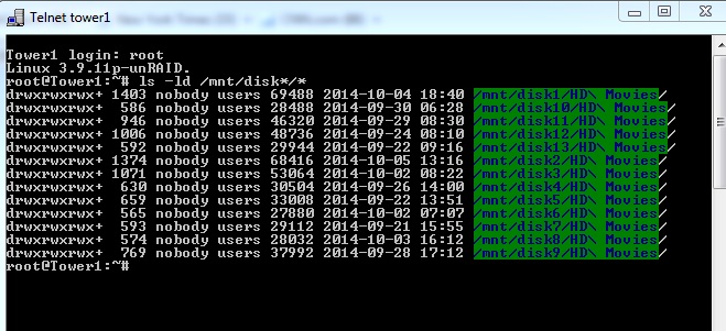

That is strange - with the -v option active you should be shown for each disk any share that is found on that as it is checked.  The output you show suggests that nothing was found.  Can you perhaps try running the command
ls -ld  /mnt/disk*/*
to check that there are in fact folders on the disk corresponding to the share names?
here you go, there are over 10,000 movies (folders + >40,000 files)
Thanks - that shows the problem!
At the moment the script is not handling correctly user shares with spaces in their names.    As can be seen from the verbose output you posted earlier it thinks there are two shares "HD" and "Movies" whereas there should only be one share of "HD Movies".  That would also explain why it completed so quickly as it could not find any files belonging to the two shares it was looking for.  Now that I know what the problem is should be easy to fix for the next release.  Unexpected spaces (and other special characters like quotes) are notorious for causing problems in shell scripts.
It is possible that using -i "HD Movies" as a parameter option to explicitly specify the share should work as a temporary workaround (rather than letting the script derive the share list automatically), but I am not sure.
thanks, I tried that, alas no luck.  I will have to wait for the next version
Yp.  I found the line that stopped the proposed workaround (some missing quotes).  I had picked up all the cases where spaces occurred in file names, but not in share names.    I have now added a share with spaces to my server so that case gets tested for next time.
