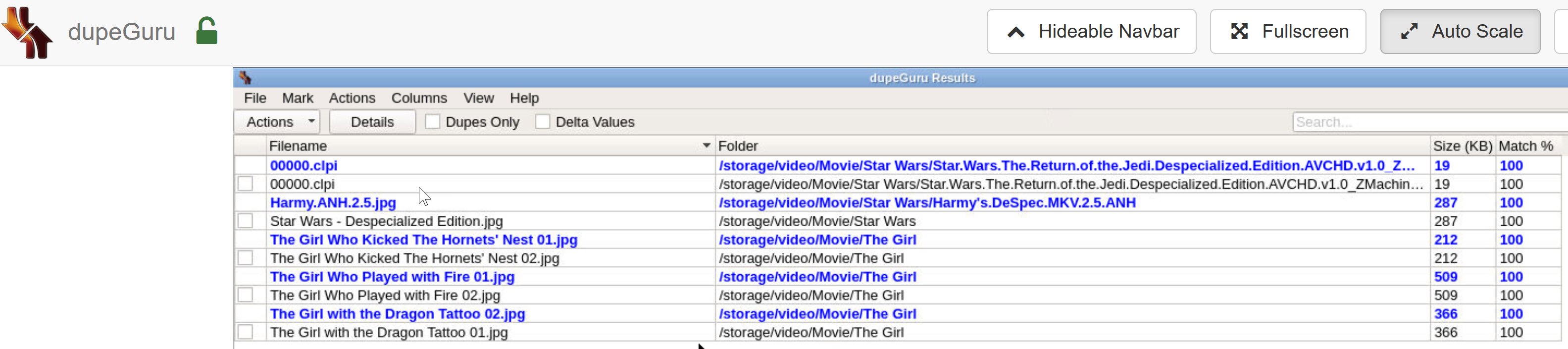

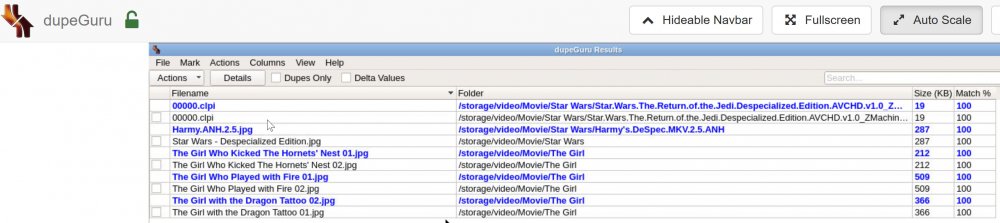

I checked community applications for "duplicate" and found dupeguru docker, and it just finished installing.  I'm running it for the first time right now, but so far it doesn't seem to be doing much/anything.
I'd prefer if this tool would do it for me instead; less to install/maintain.
**it only looks for duplicate files in the shares, not duplicates on multiple disks, so not a solution anyway
Not quite sure what you mean by this?    It looks for duplicates with the same relative path (I.e. the same name) that exist on more than one disk.  This can happen if you have been copying files between disks on unRAID and have not deleted the source files.   That can be a bit confusing on unRAID as when you look at the User Share Level you will only see one instance.     It does NOT look for files with different paths/names that have the same contents if that is what you are looking for.

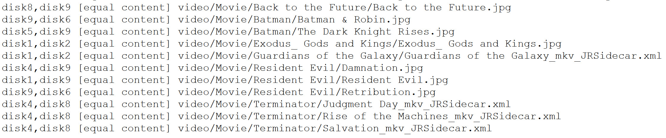

It looks like it only showed duplicate files with different paths/names, and has no reference to the disk they are on.  the file integrity plugin shows dups on different disks, like 2nd screenshot.  This is what I was looking for.  It just seems this tool doesn't update in real-time, as some of the dups it reported have been corrected, but it's still showing them.
Oh well.
Not sure what makes you think this - it definitely shows which disks duplicated files are on!   I developed it and used it to identify where I had duplicate files on my own disks.
it was developed a long time ago (on unRAID v5 although it also works on v6) before plugins like the File Integrity plugin, so feel free to use that if you prefer.
