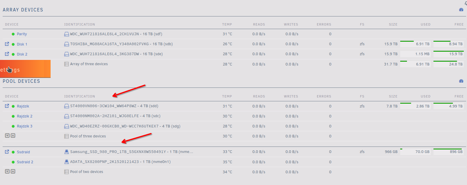

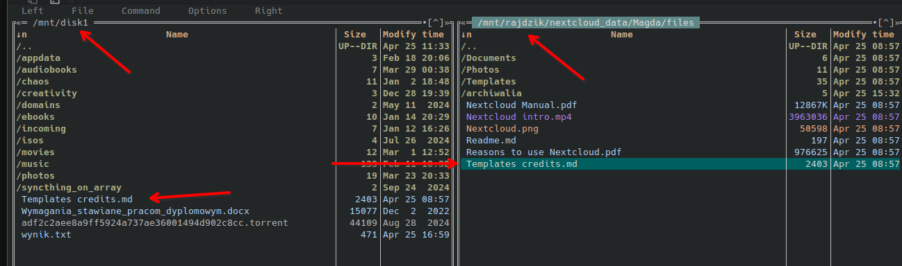

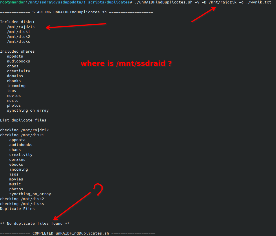

The script in Unraid 7 seems to completely fail to work. First, it skips ZFS arrays, so you have to add them via the -D parameter.
But still, it doesn't find duplicates at all, even when I deliberately created them:
Edited by jaclas
The script ignores pools - it predates pools being generally used for anything other than caching so only checks the main Unraid array.
I guess at some time it might be worth considering updating it to handle pools, and also make it a plugin and provide some sort of GUI front end.   I will put it on my 'to do' list, but no promises.
@itimpi I'll just add some more questions just to be sure.
So even though the pool is explicitly pointed out it is ignored? And even though there is information in the log about checking this pool it is really bypassed?
Your question made me look at the code - you are right there is some explicit code at around lines 311-312 which looks for /mnt/cache and if present adds that to the list of disks (as at the time the script was developed that was the only pool available and its name was fixed).
That looks like it is the area at which one could add any additional pools if present to get them included in the check to make the script able to handle other pool names.
