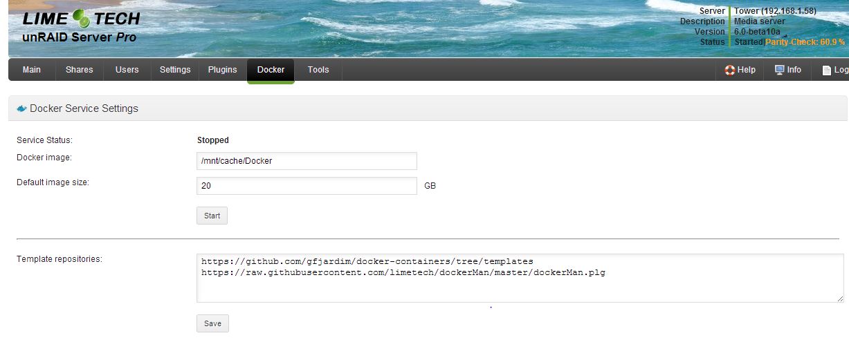

Now Docker will not start. I have the Docker Manager plugin installed.
My Docker file is located on my BTRFS cache drive. My Appdata is on my Drive 2 also BTRFS.
When I press Docker start button it attempts and goes back to the stopped state.
I noticed now the Docker file was suddenly over 10 so I changed the size to 20 with no difference. I appreciate any help to get back to where I was with Docker running.

I'm not sure whether it's the cause of your problem, but dockerman.plg shouldn't be in your list of repositories.
I could be wrong, but doesn't the path need to be /mnt/cache/docker.img  (at least thats what mine is)
I removed dockerman.plg and and changed the Docker Image location to /mnt/cache/docker.img
It made no difference. Docker will not start.
