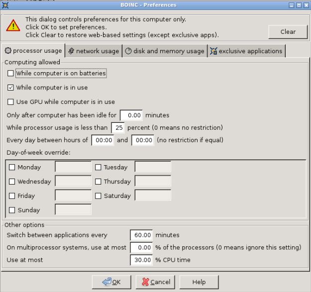

For BOINC, I don't use cpuset-cpu's because it already manages the max cpu correctly.
In BOINC menu (regular view), I go to "computing preferences" and set it to "use no more than 50% of the processor".
Then when I go to unraid dashboard I see that my cpu is pegged at 50%.

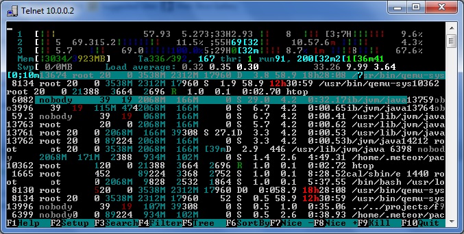

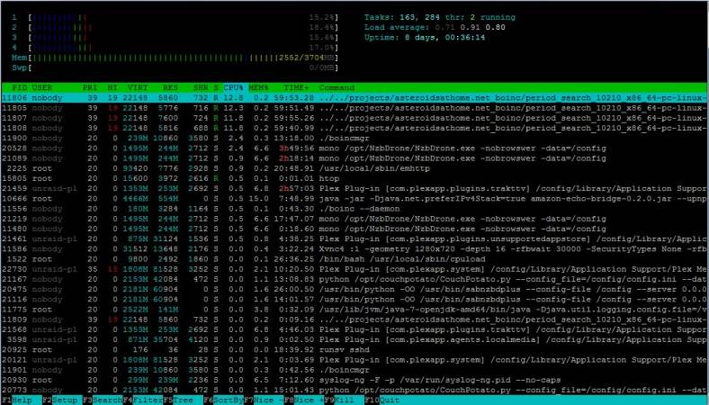

here are screenshots of Htop.
Trurl - So you see in the GUI the same as I do.  However, when mine happens, I can barely navigate through unraid menus, and like i said before, BOINC RDP disconnects.
aptalca - I have tried the 50% setting.  It seems to make no difference.  Can you post a screenshot of your settings?
Try a larger telnet window, it's very hard to read.
Attached are screenshots showing my htop with max cpu set to 30% and BOINC settings
