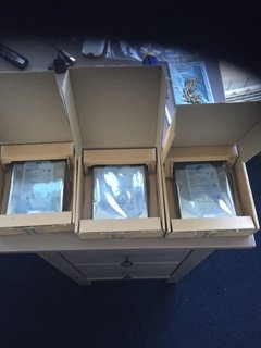

Interesting packaging! (See IMG).
Going out tonight but couldn't help taking some pictures and plugging one of the drives in. Interesting initial thing though, I tried to do an initial S.M.A.R.T report before I do a 3 cycle preclear and it appears the drives don't come with S.M.A.R.T enabled (See Screen Shot).

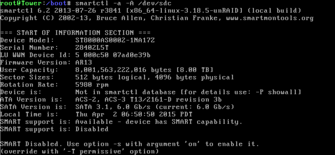

For everyones benefit I intend to do the following before I go to bed tonight:
-- Enable S.M.A.R.T (and get an initial report) --
smartctl -s on /dev/sdc
smartctl -d ata -a /dev/sdc
smartctl -a -A /dev/sdc >/boot/20150402_SG8TB1_Initial_Report.txt
EDIT: Still some time so did some investigating. No need for the above. S.M.A.R.T was not enabled by default in my BIOS of my new board for the Backup Server. I don't know if enabling it forces some other command to be executed or not but no matter - enabled it in BIOS and was able to obtain an initial S.M.A.R.T report for 3 of 3 drives (EDIT - changed file to have all 3 reports included in one file - attached).
