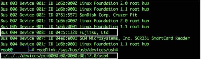

      I went ahead a bought a PCIe USB 3.0 expansion card. I installed it and started testing all the 3.0 ports. There are 7 total, 5 external and 2 internal, all 3.0. Here is what I have so far.
lspci | grep USB:
00:14.0 USB controller: Intel Corporation 9 Series Chipset Family USB xHCI Controller
00:1a.0 USB controller: Intel Corporation 9 Series Chipset Family USB EHCI Controller #2
00:1d.0 USB controller: Intel Corporation 9 Series Chipset Family USB EHCI Controller #1
06:00.0 USB controller: Fresco Logic Device 1100 (rev 10)
The Intel controller is my onboard USB ports, and the Fresco Logic Device is my PCIe USB 3.0 expansion card.
Internal - lsusb:
Bus 003 Device 004: ID 154b:00ad PNY
Bus 004 Device 008: ID 154b:00ad PNY
External - lsusb:
Bus 004 Device 003: ID 154b:00ad PNY
Bus 004 Device 004: ID 154b:00ad PNY
Bus 004 Device 005: ID 154b:00ad PNY
Bus 004 Device 006: ID 154b:00ad PNY
Bus 004 Device 007: ID 154b:00ad PNY
readlink /sys/bus/usb/devices/usb:
../../../devices/pci0000:00/0000:00:14.0/usb1
../../../devices/pci0000:00/0000:00:14.0/usb2
../../../devices/pci0000:00/0000:00:1c.4/0000:06:00.0/usb3
../../../devices/pci0000:00/0000:00:1c.4/0000:06:00.0/usb4
../../../devices/pci0000:00/0000:00:1a.0/usb5
../../../devices/pci0000:00/0000:00:1d.0/usb6

I tried passing through: 06:00.0 USB controller: Fresco Logic Device 1100 (rev 10), however that did not work, multiple errors.
My unRaid USB is the SanDisk Cruzer, on Bus 01, which is located on a 2.0 USB port on the motherboard.
A few things I have noticed is that "readlink /sys/bus/usb/devices/usb" for Bus 3 and 4, produce an extra address that the other ones do. I think this might be related to :
00:1c.0 PCI bridge: Intel Corporation 9 Series Chipset Family PCI Express Root Port 1 (rev d0)
00:1c.2 PCI bridge: Intel Corporation 9 Series Chipset Family PCI Express Root Port 3 (rev d0)
00:1c.3 PCI bridge: Intel Corporation 9 Series Chipset Family PCI Express Root Port 4 (rev d0)
00:1c.4 PCI bridge: Intel Corporation 9 Series Chipset Family PCI Express Root Port 5 (rev d0)
Which makes some sense, however that is only 5 of the 7 USB ports. I am assuming that these are the 5 external ports. Then there are the 2 internal ports. The extremely odd thing is the fact that all 5 of the external ports are on Bus 4, which makes sense, but then the internal ports, one is on Bus 3 and one is on Bus 4. So a total of 6 on Bus 4 and 1 on Bus 3.
So I am lost at what to do next, maybe there is something I need to do in the Bios??? Or could it be a driver issue? I don't know what I should try next to pass through this USB card. Any help I would greatly appreciate it.
Thanks again for the help from before! Look forward to hearing from you!

*NOT PASS THROUGH BUS 002!!!*
Want to pass Bus 001
Readlink usbx
devices/pci0000:00/0000:00:16.2/usb3
devices/pci0000:00/0000:00:16.0/usb7
devices/pci0000:00/0000:00:14.5/usb6
devices/pci0000:00/0000:00:13.2/usb2
devices/pci0000:00/0000:00:13.0/usb5
devices/pci0000:00/0000:00:12.2/usb1
devices/pci0000:00/0000:00:12.0/usb4

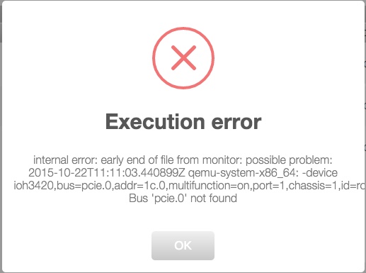

Trying few things geting same kind of error
<qemu:arg value='-device'/>
<qemu:arg value='vfio-pci,host=00:12.2,bus=root.1,addr=00.1'/>
and this
<qemu:arg value='vfio-pci,host=00:12.0,bus=root.1,addr=00.1'/>
Geting Execution error
internal error: early end of file from monitor: possible problem:
2015-10-22T09:49:42.212958Z qemu-system-x86_64: -device vfio-pci,host=00:12.2,bus=root.1,addr=00.1: PCI: slot 0 function 1 not available for vfio-pci, in use by vfio-pci
2015-10-22T09:49:42.213026Z qemu-system-x86_64: -device vfio-pci,host=00:12.2,bus=root.1,addr=00.1: Device 'vfio-pci' could not be initialized
Trying to add this in Go file, but still fails.
/usr/local/sbin/vfio-bind 0000:00:12.0 0000:00:12.2
Am missing something :/
SOLVED, i think ?? I can now hot plug usb things.

I followed this guide to passthrough the USB controller that my FUJITSU SnapScan document scanner is connected to, but I am getting an error when I try to start my Windows 8.1 VM about the following line; which the guide says is required.
<qemu:arg value='ioh3420,bus=pcie.0,addr=1c.0,multifunction=on,port=1,chassis=1,id=root.1'/>

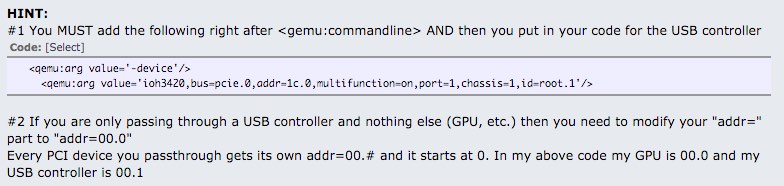

Are you passing through a graphics card as well? If not I think the issue is that instead of
It should have been:
<qemu:arg value='vfio-pci,host=00:12.2,bus=root.1,addr=00.0'/>
I don't understand why this line is required as it is written?  What if my server does not have the device ioh3420 on bus pice.0 with address 1c.0?  Please see the attached screenshots.  My XML for the VM is below.  I'm running unRAID 6.1.3.  Thanks!
What does it say if you remove the follow and try and start?
Somrething really weird is happening when i was trying to identify the bus my usb ports are on.
Ok, so I am connecting a thumbdrive from Kingston to each USB port to identify the bus. SO I plug into this certain port and the below shows when i run the command lsusb
root@Tower:~# lsusb
Bus 004 Device 002: ID 8087:8000 Intel Corp.
Bus 004 Device 001: ID 1d6b:0002 Linux Foundation 2.0 root hub
Bus 003 Device 002: ID 8087:8008 Intel Corp.
Bus 003 Device 001: ID 1d6b:0002 Linux Foundation 2.0 root hub
Bus 002 Device 004: ID 0930:6545 Toshiba Corp. Kingston DataTraveler 102/2.0 / HEMA Flash Drive 2 GB / PNY Attache 4GB Stick
Bus 002 Device 001: ID 1d6b:0003 Linux Foundation 3.0 root hub
Bus 001 Device 003: ID 0718:0246 Imation Corp.
Bus 001 Device 002: ID 046d:c52e Logitech, Inc. MK260 Wireless Combo Receiver
Bus 001 Device 001: ID 1d6b:0002 Linux Foundation 2.0 root hub
Notice the Kingston thumdrive showing that its connected to Bus 2 right?
I connect my APC USB cable to the same port and thsi is what it shows
root@Tower:~# lsusb
Bus 001 Device 011: ID 051d:0003 American Power Conversion UPS
So from bus 002 it became bus 001! I actually want to pas through bus 001 as it seems to have the most ports and I only need two ports for unRAID itself (APC UPS and the OS itself) But if it always changes like this Im afraid im almost definitely gonna end up getting my OS USB controller to pass through...
Any ideas as to why would the bus keep on changing?
Would it be because both Bus 001 and 002 are connected to the same PCI controller?
root@Tower:~# readlink /sys/bus/usb/devices/usb1
root@Tower:~# readlink /sys/bus/usb/devices/usb2
root@Tower:~#
Edit: seems to be all the usb ports are under 1 bus/controller.
Gonna have to get an external one or try out jonp's suggestion once i have the time....sigh....

So far so good so I added this to the XML:
<qemu:commandline>
    <qemu:arg value='vfio-pci,host=00:14.0,bus=root.1,addr=00.0'/>
</qemu:commandline>
During launching of the VM I get the error [glow=red,2,300]"-device vfio-pci,host=00:14.0,bus=root 1,address=00.0: Bus 'root. 1' not found"[/glow]
Here is my XML for review:

I think you need to add this first
  <qemu:commandline>
Hi again. No that didn't work. I didn't add this before because I thought it was for a card. Anyways it throws an error for the following:
<qemu:arg value='ioh3420,bus=pcie.0,addr=1c.0,multifunction=on,port=1,chassis=1,id=root.1'/>[/b]
It it possibly the address as I highlighted above?
Thanks

Depends on what the error message says? Can you post a screen shot?
