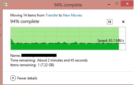

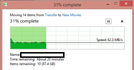

Transferring some movies from PC to unraid
120gb worth...
Getting an average speed of 60-80mb/s... <- Laptop drive seems to be the bottleneck..
Usually I get an average of 35mb/s..
The drive I'm transferring it to, is a 3TB RED. Parity is the same..
The only change to the system is I swapped out 4 X 512mb sticks of ram, for 2 X 2gb sticks?
I have no cache drive?
and almost done...

I have parity still, and it's being written to, as the files are being transferred..
RAM is same specs, just larger..
4 X 512mb =2GB - Previously
2 X 2GB = 4GB - Currently
