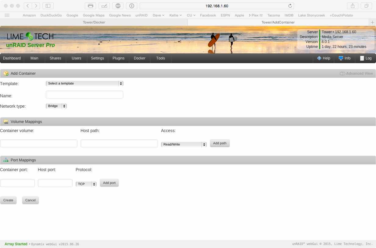

At the risk of going OT here for a minute, I've seen a couple of posts recently asking about blank templates appearing after installing an application (when using Community Applications).  Here's whats going on:
CA opens up a new tab when you go to add the application.
After filling out whatever paths and ports you require, and then hitting add, it downloads and installs the app.  When you hit Done, a blank template will be displayed.  At this point you should just close the tab.  That App is already installed.  The cancel button won't even work correctly.
The reason this happens is because how the system works without the CA plugin.  Without CA after the app is installed, the browser does a previous page to take you back to the docker containers tab.
The problem with CA that's confusing some people is that it is not part of the underlying dockerMan program.  It is an addon.  If I opened the add container section in the same tab, then after installing the container, you will wind up on the docker containers tab, and if you select CA again you will have lost where ever you were in the plugin (search result displayed, category displayed, etc).  During Community Repositories, I bounced back and forth between opening it up in the same tab vs a new tab and finally decided that a new tab works better.
Long story short, after adding the application and hitting done, you can safely just close that tab.  Nothing else is required from you (assuming you entered in the information correctly)
