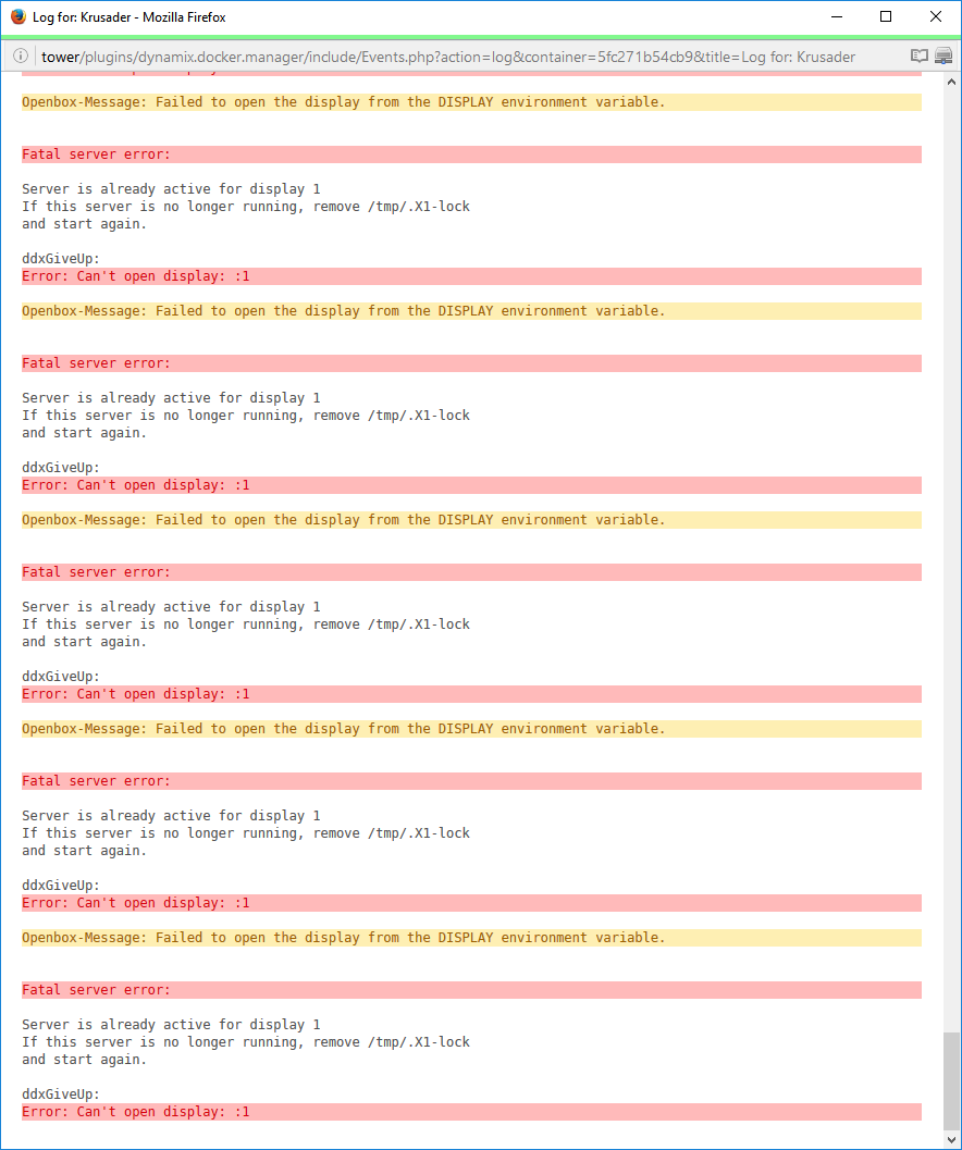

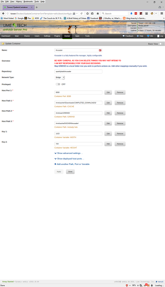

I'm having issues since the update of unraid to 6.2 and the Krusader update.  Krusader worked for years for me, but I updated unraid and your docker when the new releases came out.
When I start the docker, it goes to connecting to Guacamole, and brings up the Session: Krusader login. But when I hit OK... nothing happens.
Seems like it gets a bad display var from the logs. And searching also seems like it may be a fairly common problem: (https://lime-technology.com/forum/index.php?topic=47912.0)
Any suggestions?
Have you tried cleaning out your appdata and pulling it again.  As docker is host os agnostic, and the docker container hasn't been updated for over a year, there's no reason why it shouldn't work.
I don't use this myself, but just pulled down a copy and it works fine.  Restarted it three times, still working.
Only other thing is whether it's some sort of browser/guacamole thing, but I can't quite see how....
And it's had over 50,000 pulls from dockerhub and three people have reported intermittent issues, one of which was for makemkv, so I'd dispute the definition of common.....  ???
Nope! Tried that and it fixed it!
Thanks!
