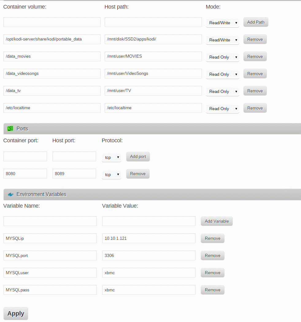

these are my settings in the template for kodi headless.
the kodi for username and password is only relevant because i set my database to accept it as a password and user combo.
previously it was xbmc and xbmc and worked as well, i updated my d/base privileges solely to take account of the name change from xbmc to kodi to maintain continuity.
How can I install mysql? Is there a link to the doctor? Or any link?

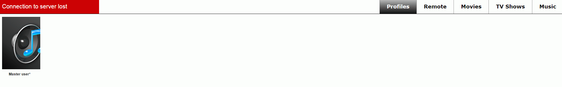

I did a default install and I can see that it has installed as the DB has the new schema.
However when I go to the webpage I am asked for a user name and password.
I have tried the default one in the XBMC forums which is xbox but that does not seem to work.
Could anyone please tell me what it is, read through these instructions a few times, I must be blind because I cannot find it.
Thanks

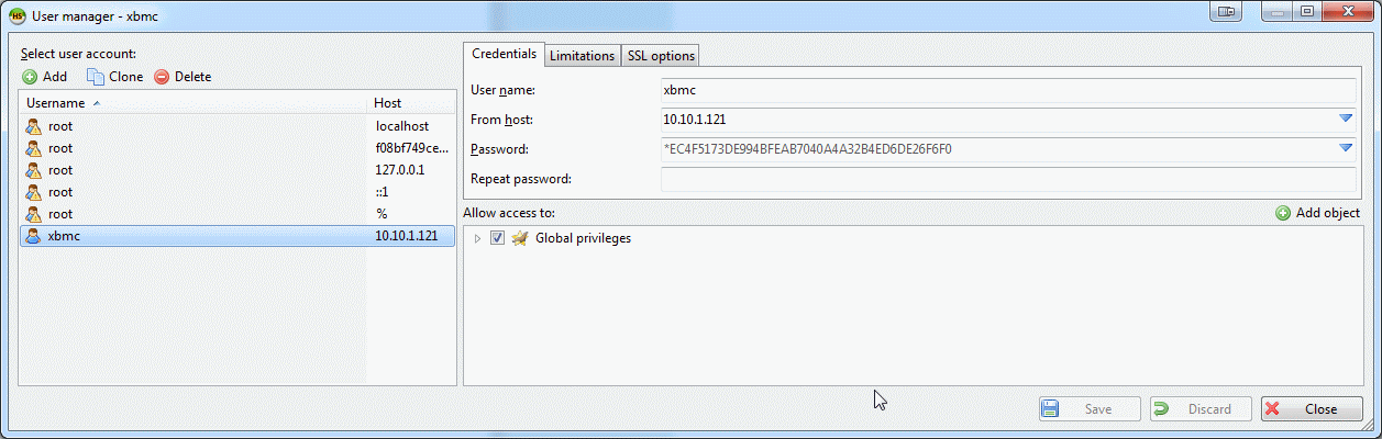

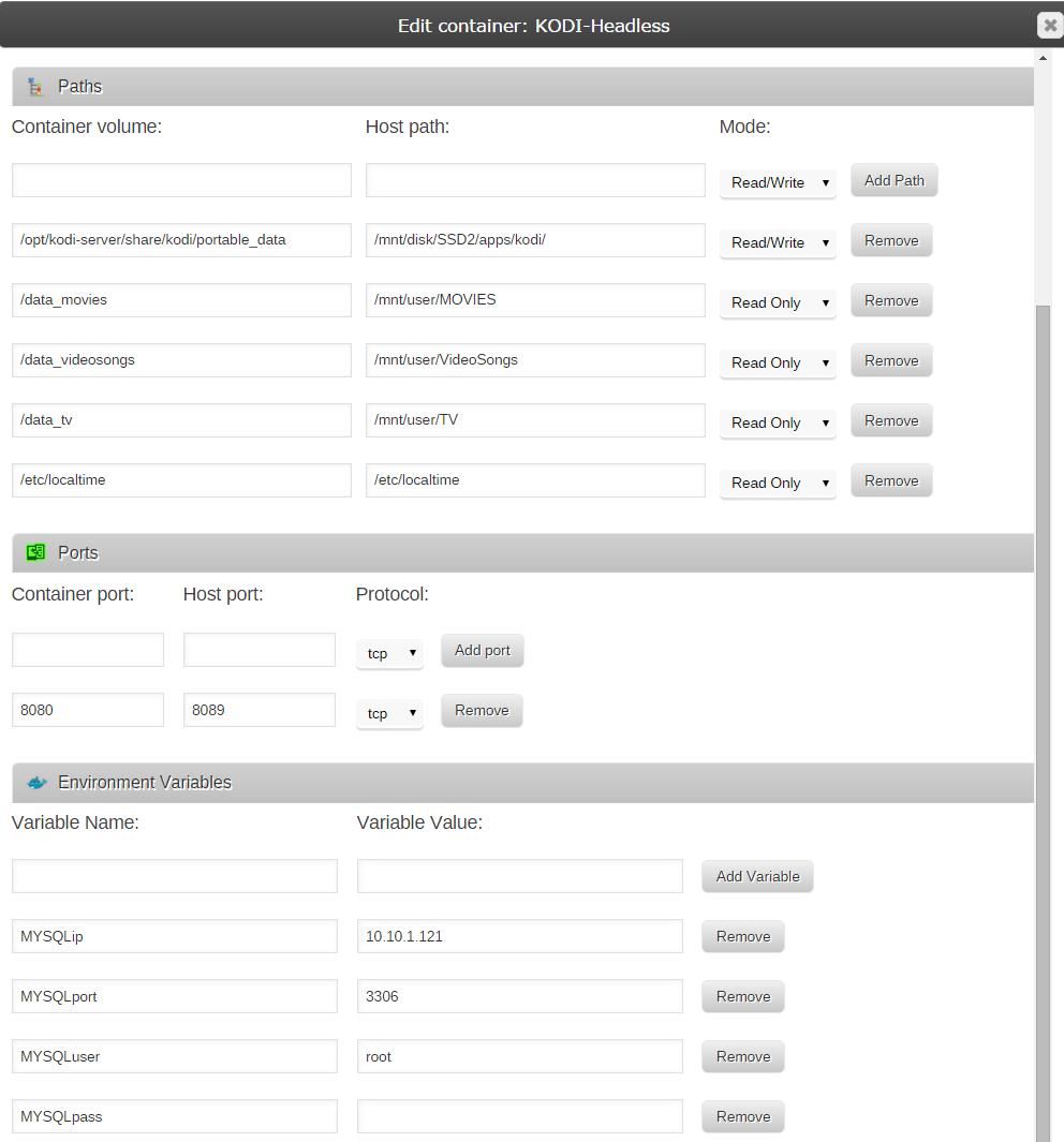

Hi - Need some help doing a fresh install of kodi-server (no db import) and mariadb. I installed the kodi-headless using the template (picture attached below) and installed needo/mariadb using
docker run -d --name=mariadb -v /mnt/disk/SSD2/apps/mariadb:/db -v /etc/localtime:/etc/localtime:ro -p 3306:3306 needo/mariadb
Installed HeidiSQL on my stand alone Windows computer and connected to MariaDB using the ip, user:root and pass:<none>. The database seems to work. My profiles.xml and advancedsettings.xml are copied below and seem to be consistent with what I read here. In Kodi-headless, after I click profiles and select the "Master user", I get connection lost red highlight box on top. Do I need to create a specific user in HeidiSQL and use that in profiles.xml? Looks like I am missing a trivial detail here. Also, how do I create new users in HeidiSQL? Thanks!
profiles.xml

Thanks Sparkly, I am still having difficulty in accessing the database from kodi, get connection lost message.
a. I created a user and pass in HeidiSQL with xbmc and xbmc with Global privileges. Is the IP address localhost (I currently have this defined) or the IP of the server address?
b. The default Mariadb login user and passwd is root:<none>. This is what I used in the definition of kodi container definition. Copied below is my advancedsettings.xml.
Seems like I am still not doing something right..

you need to create a specific user in mariadb with full privileges, use the user name and password combo in the template screen for the docker itself.
don't mess about with profiles, and the web interface itself is flaky at best.

use xbmc and xbmc for MYSQLuser and MYSQLpass in the template screen itself, if you do that you should have little reason to mess with advancedsettings.xml unless there is a specific tweak you wish to set or some of the ones i have added in there don't suit you.
Sparkly - Still not working :( I have copied snapshots below, can you have a look? The IP address 10.10.1.121 is the unraid server address.
change the host for the xbmc user to %
the way you have it set has two things wrong, docker to docker networking is internal when in bridge mode, they have their own dhcp setup and ip range, and the other is that even if it weren't, the only host that could use that username would be on your unraid server itself.
that kinda defeats the purpose of a mysql setup.
I didn't know that and I learnt something new today, thanks. I now changed the host ip to % in HeidiSQL, defined xbmc:xbmc for MYSQLuser/pass in Kodi docker. Does the MYSQLip remain as my unraid ip (10.10.1.121) or changes to localhost?
