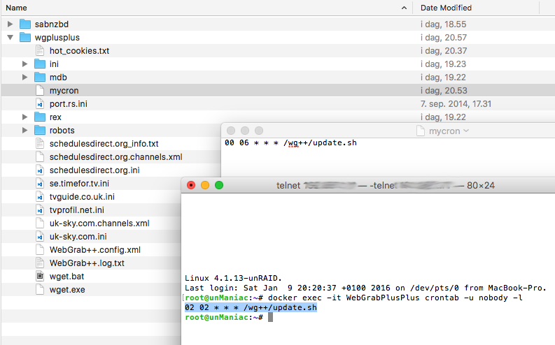

I did not understand the part with creating a file called 'mycron', what extenstion does the file have? And do I place it in the config folder of webgrabplus or somewhere else?
I am testing the automatic grabbing, but it didn't fire at the specified time in the 'mycron' file ( I restarted the container after edit).
Jeg har alltid rett ;)
There is no extensions on the mycron file. You just put it in the config folder of the docker and that should be it. On the next restart of the docker it should be added. Be sure to add this line to file and adjust the time accordingly.
02 02 * * * /wg++/update.sh

Hmmm.. that is exactly what I have done. When I restart the webgrab-docker it runs webgrab instantly and fetches the EPG, but never hits the specified time after that.
Perhaps I need to wait til the next day? Is there a way to see a list of cron jobs?

You could run this in command line to check if mycron was loaded:
docker exec -it WebGrabPlusPlus crontab -u nobody -l
It should show something like this:
35 21 * * * /wg++/update.sh
Yeah it returned the default one...
So it's probably not picking up the 'mycron' file from the /appdata/wgplusplus/ folder?
For some reason it doesn't add your mycron.
What did you use to create the file? Might be some weird apple stuff going on  ;)
I used SublimeText3, could it be permissions?  I can try via Windows and use Notepad++
It might be permissions. Try changing the owner to nobody:users
chown nobody:users mycron

Ok, changed the permissions on the file, restarted the docker, still, does not pick up settings in the mycron file. Just shows the default one...
Removed the file, created it via telnet with nobody:users, still the same. Removed the file, created it with 'Krusader' still the same...

It's working here no matter what I do to the file. Could you send me your mycron file on email and I'll see if the same thing happens here? I'll PM you the email.
Also it might be time to remove the container completely and re-install it. Might be good to use a new config folder also just for testing the mycron problem.
Ok, just for future reference: we need to add a blank line in the 'mycron' file after the settings :)
The file is now picked up and the trigger hits at the specified time :)
Thanks again!
Good that it's triggered also  :)
I'll add in the first post that there need to be a blank line in the end.
