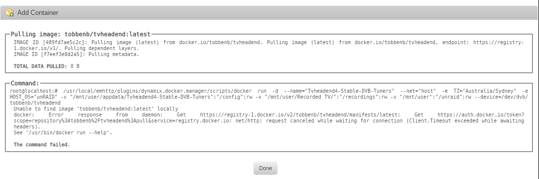

I tried again after updating the Community Applications plugin and clicking the 'Update Applications' button. Here's the output:
Pulling image: tobbenb/tvheadend:latest
IMAGE ID [489fd7ae5c2c]: Pulling image (latest) from docker.io/tobbenb/tvheadend. Pulling image (latest) from docker.io/tobbenb/tvheadend, endpoint: https://registry-1.docker.io/v1/. Pulling dependent layers.
IMAGE ID [f7eef3e8d2a5]: Pulling metadata.
TOTAL DATA PULLED: 0 B

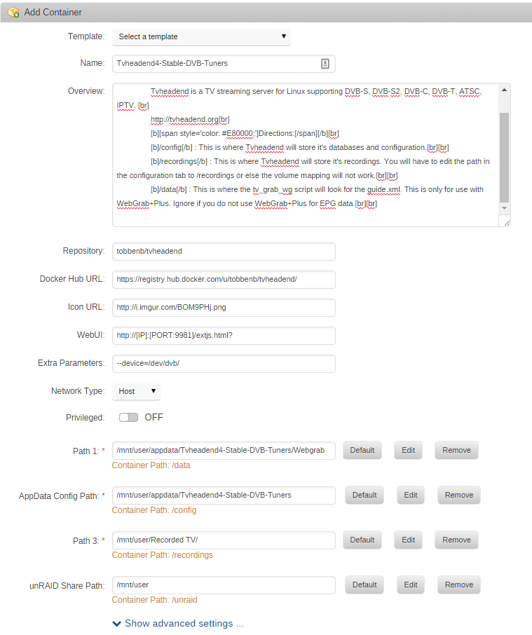

Did you use the user template when you re-installed or did you install it from CA?
Make a screenshot of the template in advanced mode.

I've been trying to create it via the 'Add' button in CA.
I've attached the template screenshot, as well as the results - the results seem to indicate maybe a connectivity or download issue (Maybe it's on my side but then why would it be limited to docker.io downloads?)
Try setting static DNS addresses in network settings of 8.8.8.8 and 8.8.4.4
I would do as squid says regarding DNS. If you have this problem on all dockers it's most likely a problem with your internet connection.
I have tested here with both 6.1.9 and 6.2.0 beta20 and have no problems.
