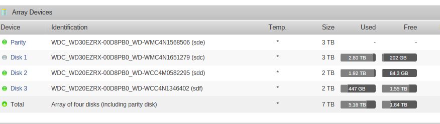

regards gui spin status, i've got temps on drives that are showing as grey.
is that right, cos i've not seen it do that before.
Had the same thing, did some playing around and this is what it looks like is happening:
poll_attributes runs every 1800 seconds (30 minutes).  Until the next polling period, Dynamix is going to show what ever value is currently sitting in disks.ini (from the last polling period) - If the drive was spun down at that time, when it spins up it will show "*" for a temperature until the next polling period... And vice versa
I changed poll_attributes to be 10 seconds, and everything is working the way that we remember with <b14.
You're just going to have to play with poll_attributes and find a value which you like
Maybe a refresh button should get put back onto Main that will poll the attributes right away
Have seen both spun off disks with temp showing and spun up disks with no temp (picture below). Don't know how to reproduce though.
poll_attributes runs every 1800 seconds.  Until the next polling period, Dynamix is going to show what ever value is currently sitting in disks.ini (ie - I had the same issue as you on one server, and my other server was showing "*" for disks that were spun up. (and that value is only updated every 1800 seconds)
it's late (or really damn early, depending on you how you look at it) so i may be well out of skew here,  but i thought they changed that polling to fix the spin down issue in the first place.
I don't believe so.  I think they played around elsewhere for the spindown, but the side effect of poll_attributes is that temperatures on drives are now only updated by default every 30 minutes.  If the drive spins up or spins down before the next polling period the gui will display the result from the last poll - which is obviously wrong.
Now that I'm thinking more about it, when a drive spins down, emhttp should update the temperature entry for the drive to be a "*".  When the drive spins up, it should automatically poll the attributes for THAT drive, regardless of the poll_attributes settings.
You can always change poll_attributes back down to the pre 14 setting of 10 seconds.  That setting was put in only to allow users to have a little more control of parity check speeds, because of the overhead involved in polling all of the drives every 10 seconds.
Huh well I guess that's a surprising result given history of how it worked in the past.
What has changed is that we separated the "check if hdd is spinning" from "read the hdd smart attributes".  This is because reading SMART data is very "expensive" operation (as explained earlier).  Especially if you have a large number of drives.  You can't just have a monitor process running the background polling SMART every second or 10 seconds or higher.  It causes everything to slow down, not only webGui page refreshes but also potentially big impact on I/O and parity operations.  On the other hand we do want to monitor SMART sometime - this is the only way you can get any kind of warning that one of your drive cage fans has failed, other than noticing the melted plastic and smoke coming out of your server that is.
I guess it might take a few iterations of tweaking to get it right.
Poll attributes on spinup, clear temperature on spindown.  I've adjusted my settings down to 300 (5 minutes)
What if device spins up due to I/O?  Maybe that's not so bad because it would just add a bit more delay after spinup... lemme think about that.
Something useful would be to see what impact, if any, a "high" SMART polling rate has on media streams.  Different players may have different results.
We've been running with a 10 second polling rate for how many years now?  I personally have never had any streaming issues, but you're right - different players might not buffer enough and that delay for smart might result in a dropped frame.
Polling at spin up shouldn't have any I'll effects other than delaying access a hair longer.  Setting the temp to * at spin down will only be an issue if the user manually issues a hdparm command to spin down / up the drives - everything would be out of sync -  but you already warned about that in the OP
Actually, all releases pre-dynamix, used 'hdparm' to only get spinning state in background.  Temperatures and other SMART data was only read "on-demand" as a result user navigating webGui.  In analyzing where time is spent in each page refresh, this operation accounted for most time, especially on larger arrays.  Go back and boot unRaid-5 and you'll see the page navigation is not as "snappy" - this is entirely due to reading SMART.
So I just added the code to do above - not so bad.  What's left is to detect transition of spun-down to spun-up due to I/O and trigger start of a SMART poll because of it.
