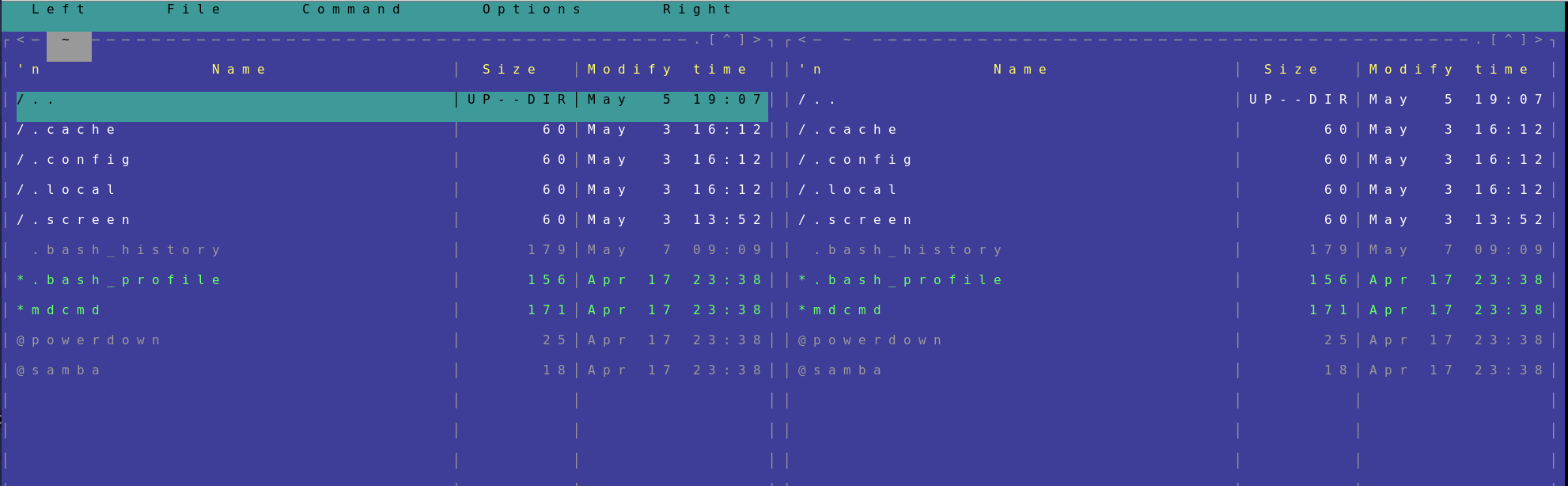

Guacamole fonts....
On an early Unraid6b everything looked great on ssh sessions but now I'm using 6b15 the fonts for ssh are not correct - see attachment. I have tried changing the size and it makes the font bigger but the gaps are still there.
Do I set a default terminal type for ssh somewhere or is it in Guacamole?. The Guacamole boards talk about installing other fonts but I'm not sure that is the problem.
I have 6B15 with Nerdpack plugin (has Screen command - could that cause it?)
