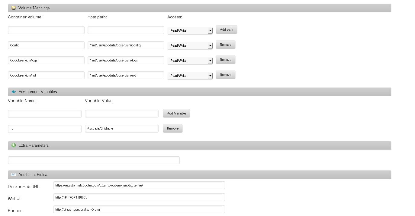

OK....
Did you read the documentation?
In the dockerhub page linked to from the container setup...
To set the timezone for Observium, pass in a valid value as an environment variable:
-e TZ="America/Chicago"
Click advanced and add TZ = WHEREVER_YOU_ARE to the Environment variables...
No I didn't :(
The template set the config locations for me, so I skipped that.
Is the following screenshot correct?
Hasn't resolved it. Even deleted a device and readded it to see.
I've noticed when I apply this change, the Command result shows the following.
root@localhost:# /usr/local/emhttp/plugins/dynamix.docker.manager/scripts/docker run -d --name="Observium" --net="host" -e TZ="Australia/Brisbane" -e TZ="Australia/Brisbane" -p 8668:8668/tcp -v "/mnt/user/appdata/observium/config":"/config":rw -v "/mnt/user/appdata/observium/logs":"/opt/observium/logs":rw -v "/mnt/user/appdata/observium/rrd":"/opt/observium/rrd":rw zuhkov/observium
1f3dd629bd7732fb7c7dcf5d647abe3ed30bc207f1eb88ff8590987dedfeb96e
The command finished successfully!
It shows -E TZ="Australia/Brisbane" correctly, but twice? I've cocked something up there. Would this stop it from working?
