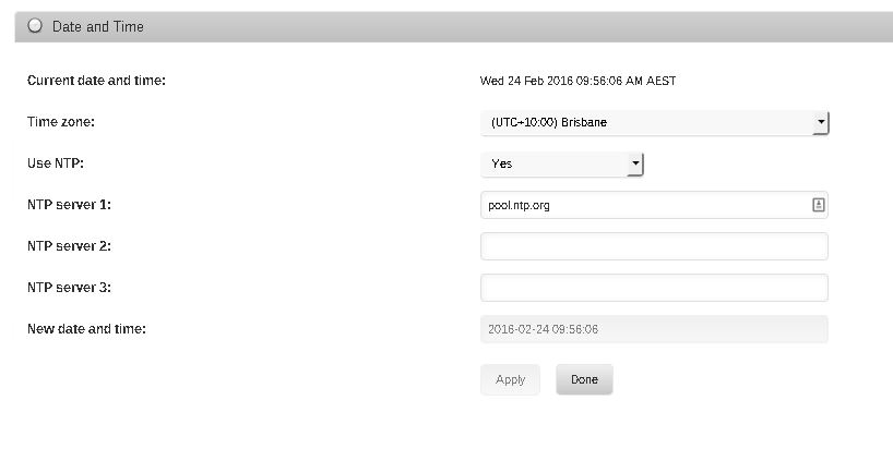

I just downloaded it to check and it's passing my time through correctly without any additional parameters..
Daft question, is the timezone and time set correctly on your Unraid box?
  • Replies 179
  • Views 55.8k
Yeah seems to be:
There is also this "Bind Time" option that is set by default.
Maybe that needs to be off for the variable to work?
Same issue with or without "bind time" option enabled.
confirmed /etc/localtime is set to correct timezone
