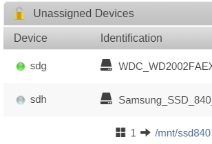

I'm having some problems with the SMB function of unassigned devices (dlandon version).
I have a SSD than I mount with unassigned devices and I want to be able to have full access to this SSD from my windows PC while others on the network cannot use it (so I need SMB security).
If I set in settings "Enable SMB Security:" to 'No' then I can from windows create a directory on the drive (and delete this dir).
If I set in settings "Enable SMB Security:" to 'Yes' AND give the admin user I use to access all my other shares on the server with read/write access, then I get permission denied when I try to create a new directory. I CAN browse the drive, but it seems only readable...
Does SMB security set to yes work for somebody else (this would mean I'm doing something wrong...)??
Thanks!
I can reproduce the issue and will work on it.  Do you happen to have the Recycle Bin plugin installed?
Thanks!
Did it work in the latest gfjardim version?
Don't know, haven't used it before...
Thanks!
No, I have not installed the Recycle Bin Plugin
BTW, thanks for all your work!!!

Thanks dlandon for working on this! Curious if this version spins down the disks that haven't been active after 15 mins? Mine seems to stay active always.
I don't know.  I will have a look.
Please update to version 2016.01.17c.  I fixed what I broke in unassigned_umount.
The sleep time is set to 15 minutes.  I have a WD red that spins down just fine.
The sleep time is set by unassigned devices using: hdparm -S180.  Your drive has to be able to respond to this command.

The unassigned SSD indicates it is in STANDBY mode by the color of the status indicator. Shouldn't it be green if it is currently mounted?
Sorry, I was editing this post while you responded already.
