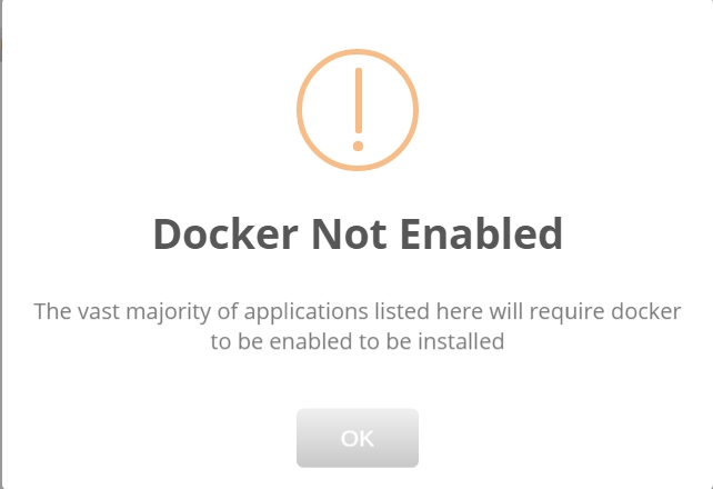

Ever see this?
Yes.  What version of unassigned devices do you have installed?
I uninstalled unassigneddevices plugin via the plugin page. Rebooted. Then I kept getting a snag pop-up about dockers not enabled because my docker IMG file is on one of my unassigned drives - makes sense. I disregarded that pop-up temporarily and installed YOUR version of unassigneddevices via a lookup within Community Applications. Rebooted again and the docker pop-up went away and things look normal so far. No errors in the unassigned.devices.log and my unassigneddevices shares came up as normal. Thanks for taking care of this.
Using this version now - 2016.01.16a
