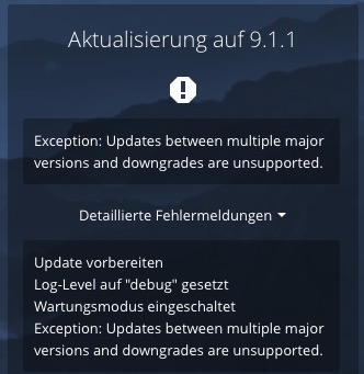

ownCloud Docker:
I saw that the update to ownCloud 9.1.1 was available today. After having clicked at the UPGRADE button I saw the error message below.
Any advise?
What version were you on previously? My guess is you're doing an upgrade over several versions when you should be upgrading to intermediate versions first.
Sent from my Nexus 5X using Tapatalk
I was coming from 9.1
No worries Bunny, I will try the Nextcloud docker now. Thanks for all your support.
Strange. I was able to upgrade from 9.0 to 9.1.1 without much issue. I had to disable my apps directory in order to get the upgrade to proceed properly, but it eventually worked. I'm not sure what your issue is, but if you want to stick with owncloud, it may be worth contacting owncloud's support staff or searching their github issues page.
